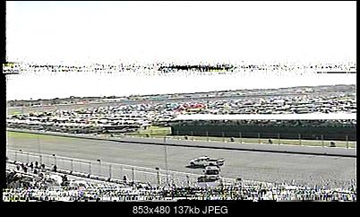

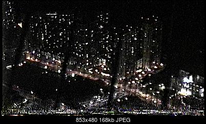

    So, there's no fixing these issues?Click image for larger version
ID:	42927Click image for larger version

    That could be creasing, especially if it moves up and down. Eject the cassette when it shows this, open the door, and take a look at the physical condition of the tape.
