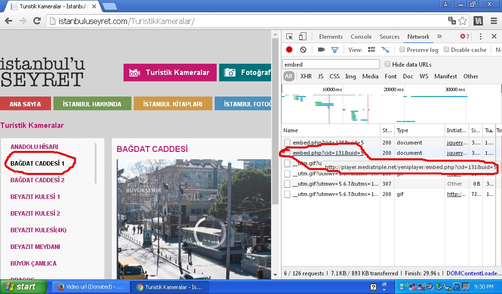

    Note: to get other cams, for example the second one (BAĞDAT CADDESİ), play the video in Chrome Developer Tools and search for
    embed
    and find this (see second screenshot)
    http://player.mediatriple.net/yeniplayer/embed.php?cid=131&uid=5
    which becomes this:
    livestreamer --http-header  "Referer=http://istanbuluseyret.com/TuristikKameralar/" "httpstream://http://player.mediatriple.net/yeniplayer/embed.php?cid=131&uid=5" best -o source.txt
    The only thing here that changes between first and second webcam is 128 becomes 131

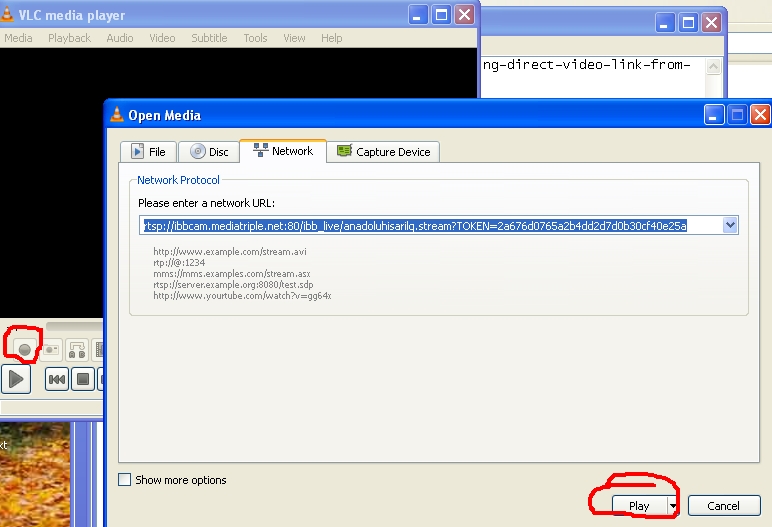

    rtsp://ibbcam.mediatriple.net:80/ibb_live/anadoluhisarilq.stream?TOKEN=2a676d0765a2b4dd2d7d0b30cf40e25a
    Note: you must do this step because the last part (TOKEN) will change after awhile
    Second webcam (BAĞDAT CADDESİ) gives this:
    rtsp://ibbcam.mediatriple.net:80/ibb_live/bagdat1lq.stream?TOKEN=2a676d0765a2b4dd2d7d0b30cf40e25a
    6) put this into vlc > media> open network stream
    and press play to watch the live video. You can also record by pressing the red record button
    (see screenshot 1)
