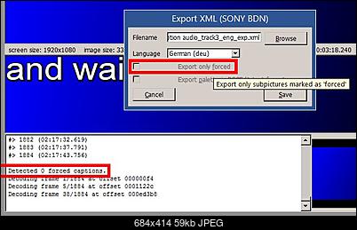

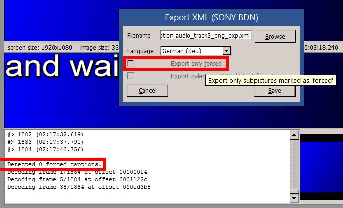

  6. Doesn't look like your subtitles has any forced subtitles.
  7. Don't think the movie does but was confused when I saw them as a selectable subtitle option in the video playback. Can you please tell me how you found that out so I know how to check for myself in the future. The Bluray still shows 2 sets of subtitles though. Is there a way to remove the fake forced subtitles so it doesn't appear in the Bluray as a selectable subtitle file?
  8. Originally Posted by VideoFanatic View Post
    Look at the screenshot he made for you. He marked it red: "Detected 0 forced captions" (and the filter option is greyed out when exporting).
