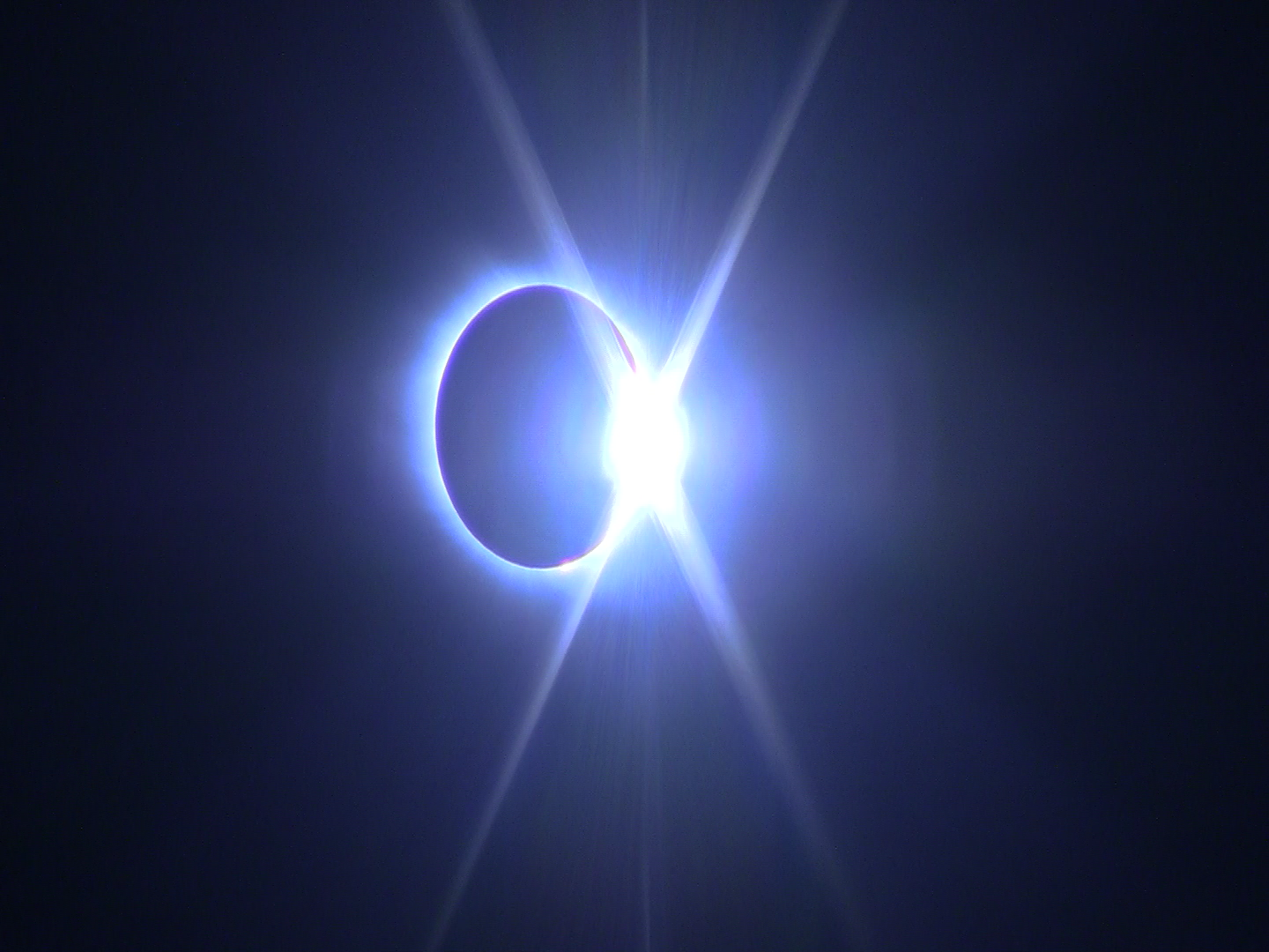

    I've got lots of video files of the eclipse and want to use some tools which can align the video frame to correct for the earth's movement. I've seen a java program made for medical imaging called ImageJ that has some plugins which may be helpful and I want to give those a try.
    I'd like to use Vdub to create the images but I've run into a problem I don't know how to correct. The source files are Canon AVCHD files recorded at 1440x1080 and when vdub outputs the image sequence it does as 1440x1080 (surprise!). But this display aspect ratio isn't correct as this is a HD (16:9) format. I can't find how to adjust the DAR for the source files. Is there a way to get vdub to output an image sequence with a correction for the 16:9 DAR?
    My recordings were several 4 minute clips where the sun/moon move from the upper left to lower mid edge and I'm hoping to post process this to center everything. I'm also interested in hearing other ideas there are better ways.
    I've attached an image to show what I mean about the AR on the images...

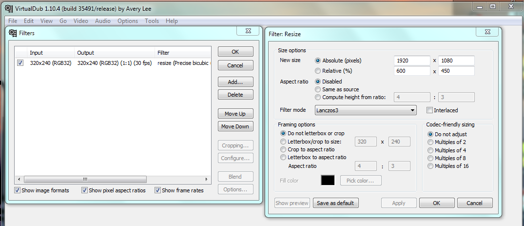

  2. You would use a vdub resize filter to 1920x1080 before exporting

    AVCHD supports full 1920x1080 and 1440x1080 (usually used to reduce bitrate), but obviously you used 1440x1080 mode. So in vdub you can use a resize filter like lanczos3 to get 1920x1080. Another thing is that your image has slight hits of interlacing, so if you recorded at 29.97fps or 25fps then it is interlaced. Some AVCHD cameras (maybe all) support 23.976 progressive recordings with AVCHD which would not require deinterlacing.
    [Attachment 42915 - Click to enlarge]

    You were told what to do in earlier: resize to 1920x1080 or some other 16:9 frame size (players do this automatically at playback) . Be sure to disable the "Aspect ratio" option in VirtualDub's resize filter so it doesn't try to retain the 4:3 frame aspect ratio of your source. And if you change the vertical size you must deinterlace first.

    Thanks, I've been using the filter sequence of de-interlace (went with default setting since it's the sun and slow enough there's very little interlacing that I can see), resize (Lanczos3). I had hoped there would be a way to not resize but also figured it couldn't be avoided.

  8. You don't have to resize; you can encode it with a 16:9 flag like your source. But only media players will play it back properly. If you upload it to a website like youtube it will be "squished" . So it's "better" to resize to "square pixel" equivalents - because it will playback properly everywhere
