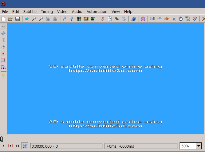

  8. Perhaps check the subtitle from http://subtitle3d.com/ in Aegisub with a Video -> Use dummy video.

    Ok, the encoding worked and the subtitle is there, H-OU or TB perfectly aligned. Now the problem is that the resulting file (after 5 hours of encoding in Slow mode) doesn't reproduce properly on my TV. The file appears as unplayable. Are there any standard XMedia x264 settings for LG 3DTVs? I'm reencoding the resulting file with VidCoder, which has a bullet-proof profile made by me (which I've used as a template to encode in XMedia with bad results), but it will diminish the quality and it's 2 hours more...
