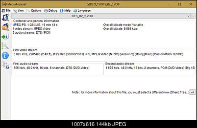

  6. But what type audio track it is?
    2 channels stereo AC3/pcm?
    or 5 channels DTS/AC3?
    you can check by drag and drop biggest VOB to MediaInfo:
  7. It may be a 'knock off', it may be an unintended fault with the disks or it could be multi-channel audio with VLC messing them up or downmixing them to stereo improperly. Have you tried a different media player, such as MPC-HC, to see if the problem exists there as well?
