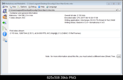

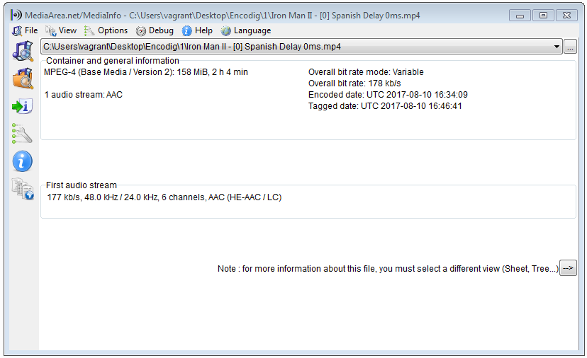

    Video stream before muxing:

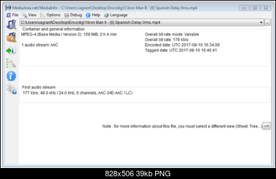

    Audio stream before muxing:

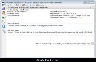

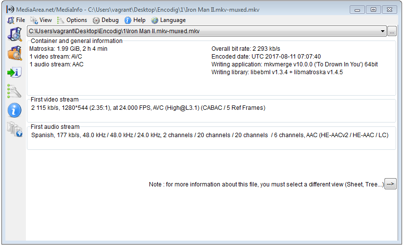

    Final result:
    This audio channel in the final file is correct? I was waiting for AAC 6 channels
    Thanks in advance for your help.
  2. That doesn't look normal indeed. But I don't know what the problem is. Maybe bug in AAC encoder/mp4 muxer. Or in mkvtoolnix. Or in MediaInfo.
    Can you upload the mp4 file? How did you create it (software, command)?

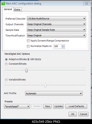

    I used Megui for all the process. Regarding tha audio this is my config:
  4. I can't reproduce. Need sample file and MeGUI log. Can NeroAacEnc even create 6 channel HEv2?
  5. Excuse me for lag of information.
    complete_log.txt.zip
    Here you have the log. It seems there are some kind of error in mux fase.
    I'm working in a sample file with the same error.
    Many, many thanks.
  6. I still cannot reproduce. What MediaInfo version are you using? Mine is 0.7.98.
  7. The same version here.
    Still working in a sample.
    I'm cutting the video and audio for a sample. But when i join to get the "wrong" file i get a "correct" one.
  8. I don't understand anything.
    If i "cut" the audio file and i join the result with the video, always i get a "correct" file.
    I have done various retries and allways i get the same result. I finally have corrected the file cutting the audio using the full lenght of the video.
  9. Maybe it's just a MediaInfo bug. But without sending the file to the MediaInfo dev we will never know (and it will never get fixed).
