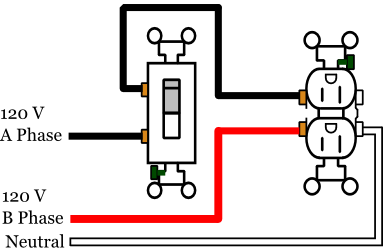

  22. This is to support only one small part of what I said above: "sometimes a dual outlet connects to one leg on each outlet"
    http://www.electrical101.com/split-receptacles.html
    Note Ground is not shown in the diagram. Like I said: two hot, one neutral, one ground.

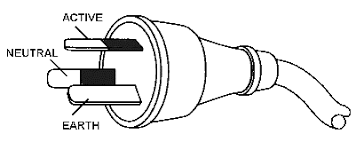

  24. Member netmask56's Avatar
    Sep 2005
    Sydney, Australia
    Here in Australia we have 240 vac to the power point - very rare these days to have 415 volts
    Looking at the socket Active on the left and neutral on the right with earth in the middle at the bottom.
