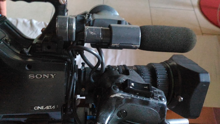

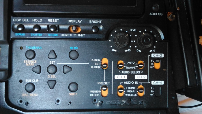

What I have to do exactly? In many situations happens that the operator in the camera forget to set the switch of audio CH2 (is the audio from the panoramic microphone of the camera, this
[Attachment 42808 - Click to enlarge]
) to "front" position.
[Attachment 42807 - Click to enlarge]
THis happens for example when during an interview where in CH1 I put audio of interviewd person, and audio of the journalist in CH2. At the end of interview I forget to set the audio CH2 from "rear" (line/mic line) to "front" (microphone camera) so that the audio in CH2 was null, muted. Nle editors-man usually considers overall audio of ch1/ch2 and ignore all the rest of audio channel, or for example during my batch that generates MP4/h264 transcoding of the footage, the batch consider only CH1 and CH2 and generate an MP4 with stereo audio L+R in witch the L channel (CH2 from camera) was null. I try to do a batch that extract CH4 where the audio-camera is alwais recorded [if you see in my photo I have phisically removed the switch to ensure it is alwais set to "front") and rebuild the original MXF with the CH2 (catched from CH4).

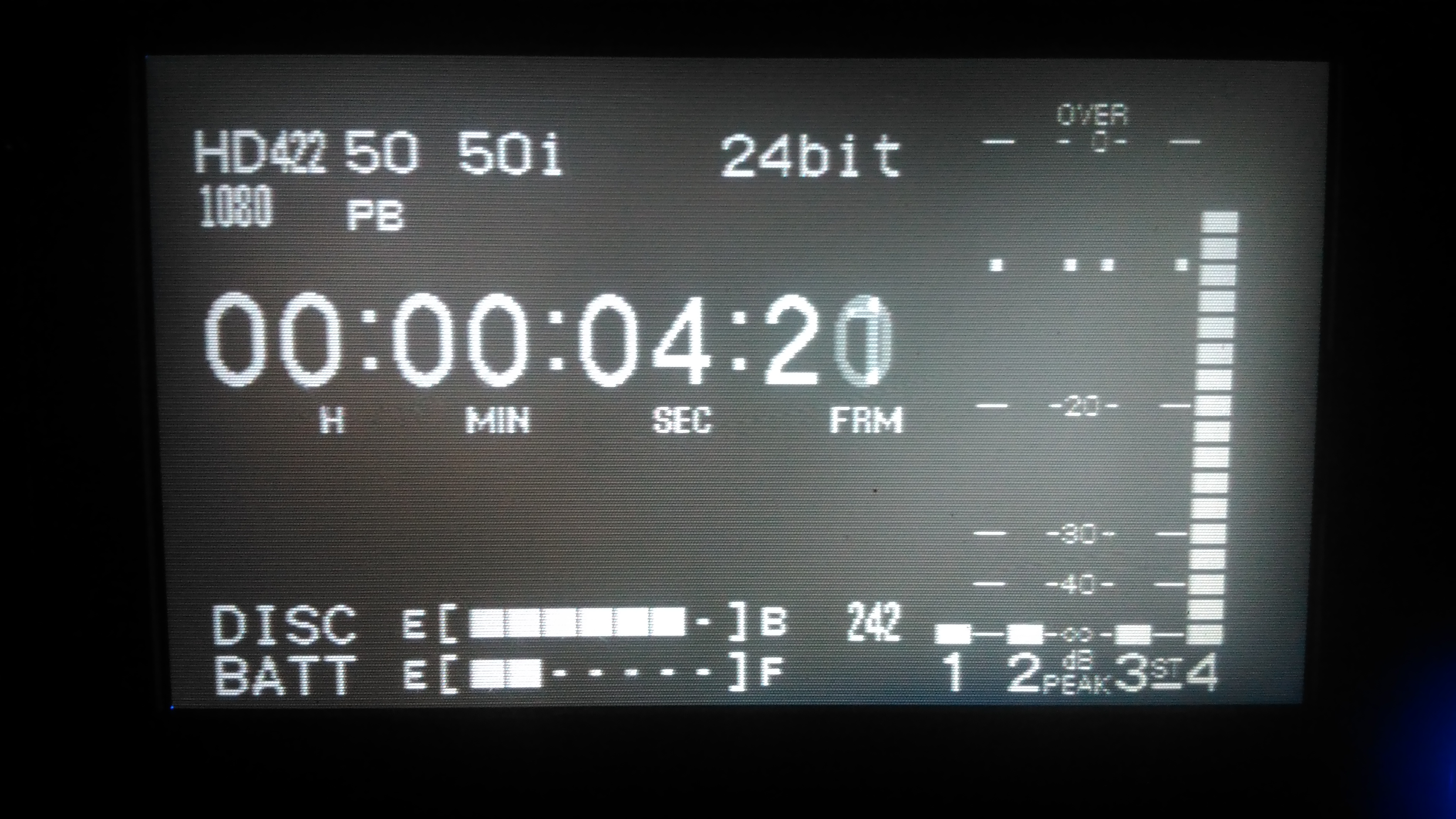

[Attachment 42809 - Click to enlarge]
now it's all clear, thanks :d:d:d:d:d:d
