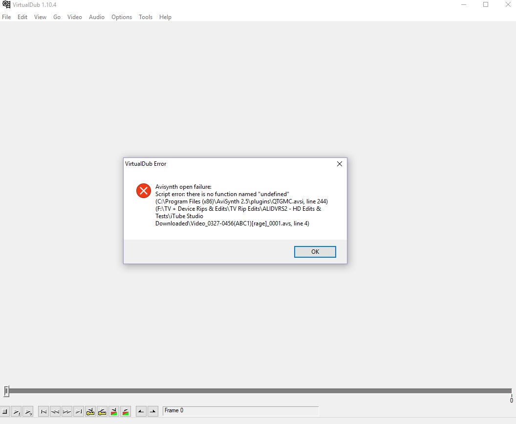

    Oh thanks jagabo for that script but its giving me this error when doing it...
Name:	VirtualDub Error.jpg
  10. Did you get QTGMC and its dependencies? It's a third party filter and isn't built into AviSynth
  11. You can use Yadif(mode=1) instead of QTGMC(preset="fast"). It's not as good but it's usually adequate. And faster.
