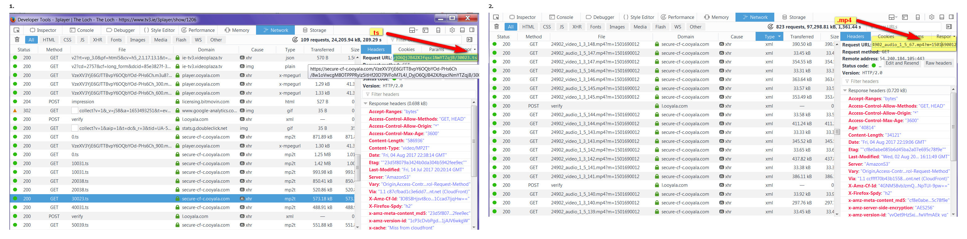

  1. Tv3 Ireland tv3.ie seems to have recently changed the way it streams. It was .ts and a typical livestreamer code would be livestreamer "hls://http://player.ooyala.com/player/ipad/I5cW80YzE6mBA3GVIXmlX-A7TZg0Px2k__2200.m3u8" best -o video.ts
    Now as far as i can see it is a whole lot of mp4 segments
    Livestreamer gives the error" Could not open stream: Unable to open URL: http://player.ooyala.com
    /player/ipad/I5cW80YzE6mBA3GVIXmlX-A7TZg0Px2k__2200.m3u8 (404 Client Error: Not
    Found)" with the mp4 videos but will still download the slightly older video.ts
    I tried youtube dl to see what would happen. The result of youtube-dl "http://player.ooyala.com/player/ipad/I5cW80YzE6mBA3GVIXmlX-A7TZg0Px2k__2200.m3u8" best -o video.ts
    giveS result "ERROR fixed output name but more than one file to download" How do i find and join those files. Here is a screenshot of two different streams the ts, which i can download with livestreamer on left. On the right is the mp4 which has a load of mp4's like
    https://secure-cf-c.ooyala.com/I5cW80YzE6mBA3GVIXmlX-A7TZg0Px2k/1/dash/24203_video_1_4...4?m=1501456786
    Do I join these and if so how

    I think maybe the ones you tried are a little older. I can get one from about month ago too. it seems only the latest use the mp4 segments. Here is another shot of all the mp4 segments. It is a different video but also recent
    Thanks for your help

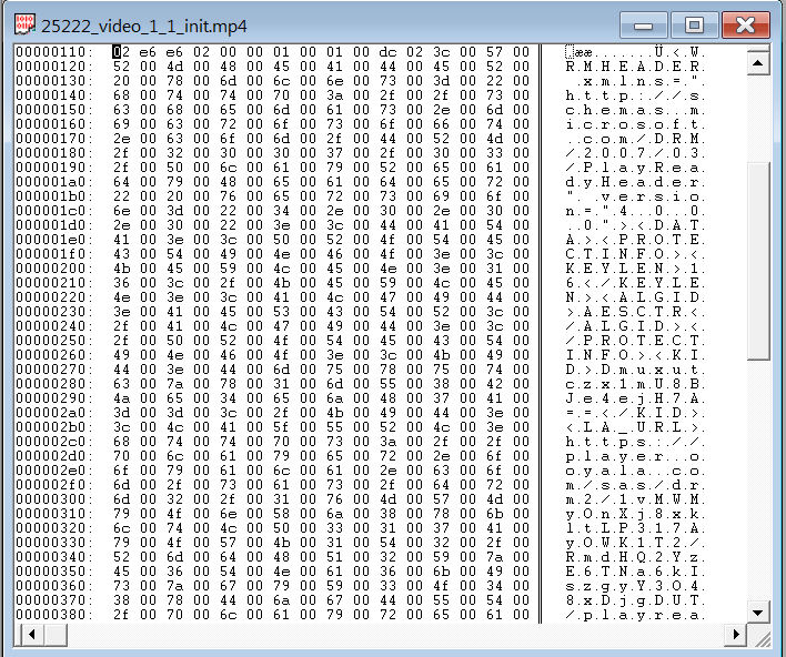

  7. Are you able to play any of the individual files? I downloaded a few but none of them played. Appending them didn't help. Looking at them in a hex editor shows metadata that implies they are encrypted.
  8. Originally Posted by jagabo View Post
    No i cannot play them. I tried open in new url and it said the file could not play as was corrupt. I downloaded it. 34kb won't play. when i try to open with mediainfo i get a pop up which says invalid floating point operation. Then media info opens with no content and says You must at least open one file.
    I opened it in https://mh-nexus.de/en/downloads.php?product=HxD but I would not know if encrypted? What to look for? Thanks
  9. In a hex editor you can see references to keys, drm, etc. in the header:
    Viewed as plain text:
    WRMHEADER xmlns="http://schemas.microsoft.com/DRM/2007/03/PlayReadyHeader" version="4.0.0.0"><DATA><PROTECTINFO><KEYLEN>16</KEYLEN><ALGID>AESCTR</ALGID></PROTECTINFO><KID>Dmuxutczx1mU8BJe4ejH7A==</KID><LA_URL>https://player.ooyala.com/sas/drm2/1vMWMyOnXj8xkltLP317AyOWK1T2/RmdHQ2YzE6TNa6kIszgyY3O48xDjgDUT/playready_cenc/ooyala/version/1</LA_URL></DATA></WRMHEADER
    [Attachment 42786 - Click to enlarge]
    I see it now. Does that mean it cannot be downloaded?
