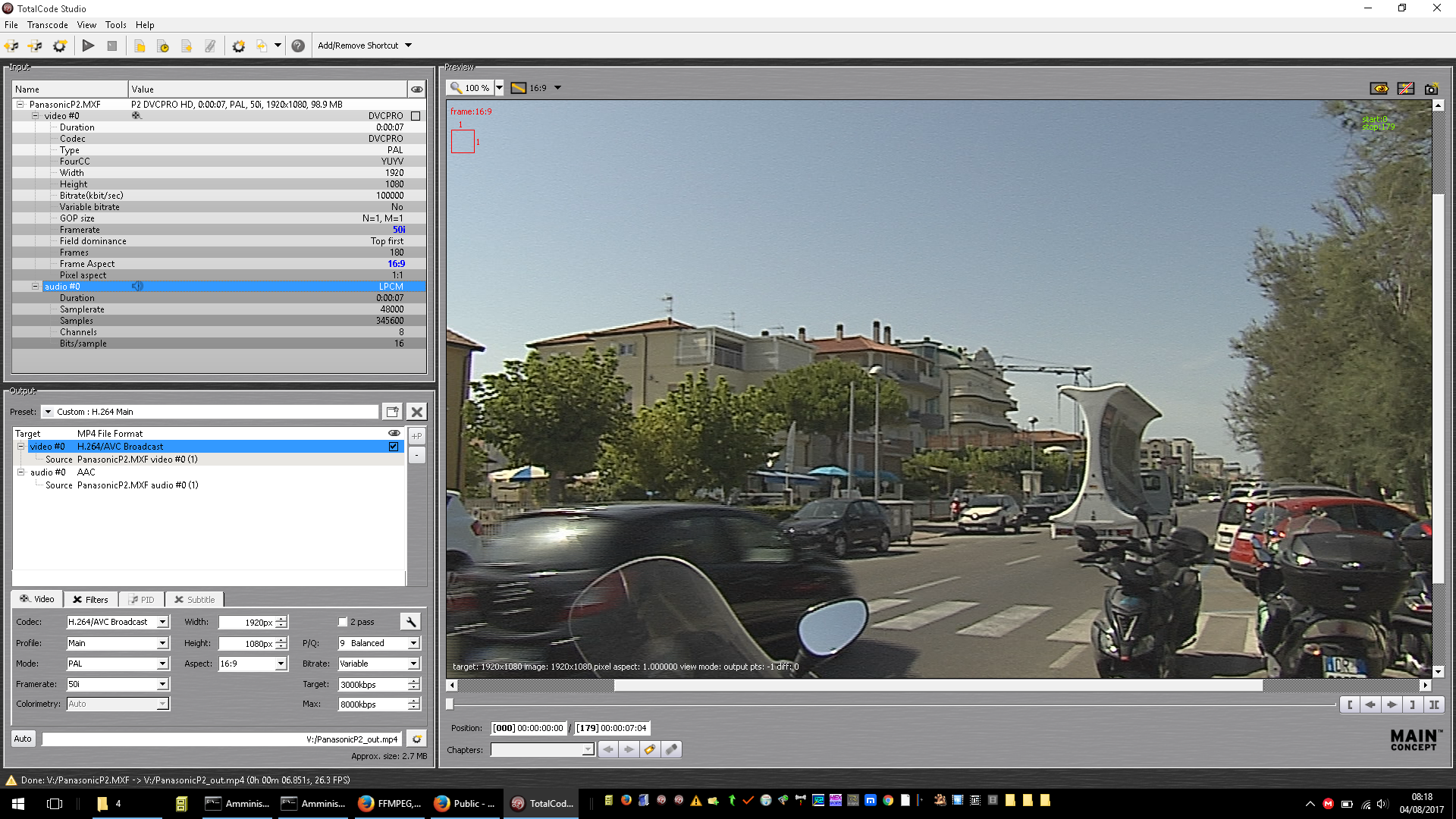

  3. Oh, but how is possible?
    I don't have try to open it with some NLE like avid or edius because I don't have they installed. But I have try to open it with Total Code Studio 3.5 and seems open well without errors
    [Attachment 42720 - Click to enlarge]
    Try to encode I get the attached with a regular audio on CH2 that I ear, maybe there is something we are not considering? seems strange
