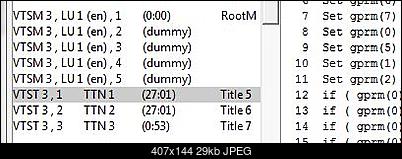

  15. Ping r0lZ:
    So, it is as if I am in junior high math and you are in advanced calculus. This is meaningless to me...
    Not sure. The problem can be caused by the "VOBU Still Mode", a trick used for example for the slide shows (where the VOBU contains a single frame with a certain duration of audio). It is well known that most video converters ignore the VOBU still and convert only the single frame, hence the audio sync problem.
    Unfortunately, the duration of the still is never written explicitly in the IFO or VOB file. You may discover it by examining the time codes of the current and next VOBU with VobEdit, but it's not easy. However, it is easy to find the right duration if the VOBU still is used only once in the cell (like for most slide shows). You can compare the duration of the whole cell with the duration of the video really converted by the program to compute the number of frames that must be added to be in sync with the audio. You can easily see the cell duration of the cell with PgcEdit: Open the DVD, select the title to examine in the left pane, and click the Edit PGC button to open the PGC Editor. Examine the "Playback Time" of the cell containing the still VOBU. (The time codes are in the form HH:MM:SS:FF, where FF is a number of frames at 25 fps for PAL or 29.97 fps for NTSC.) If you know exactly the number of frames or the duration of the video extracted by handbrake, it is trivial to compute the number of missing frames. It might be more difficult to compute the info if the PGC has several cells and you don't know in which cell the VOBU still is used, but that should be possible anyway.
    Good luck!
    Do you have a primer available for this tool, or since my need is much simpler, can you dumb it down a bit more? I have a DVD where each scene has its own VOB set. Referring to your reply above, "select the title in the left pane" -- each scene has 4 VTSM entries and 1 or more VTST entries which correspond to the number of files of its VOB set.
    When I look at the first VTSM entry (the rest say dummy), if I select EDIT PGC, I see some interesting stuff:
    None of this makes any sense to me. For each scene, there is a single frame that is repeated for about 3.5 seconds. I don't see a value anywhere close to that in the above screenshot.
    It is also interesting to note that VLC plays the single frame, followed by the video when given the VIDEO_TS.IFO file but sort of hangs for the same amount of time, and then plays the video when given the VTS_XX_01.VOB file.
    I hope you can clarify this for me -- clearly you have a way to determine the number of frames to replicate the still frame for, but I'm currently too uneducated to understand.
    Regards,
    Jon

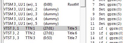

  17. Originally Posted by jond View Post
    Ping r0lZ:
    The left pane shows you the "domains" of the DVD, for each VTS (Video Title Set). The VTSM domains are reserved to the menus, and the associated VOB file are VTS_XX_0.VOB (where XX is the VTS number). You are not interested in that domains. (The first domains, VMG and VMGM are also dedicated to menus and startup stuff, and are also of little interest for you.)
    The VTST domains contain the Titles (the movies or episodes). The video content of a title is somewhere in the VOB files VTS_XX_1.VOB to VTS_XX_9.VOB (depending of the duration and compression of the video). Note that the VOB files cannot be larger than 1GB, and therefore a single title may require several VOB files. Similarly, several short Titles can be in the same VOB file. So, do not try to process the VOB files directly. That doesn't make much sense, as usually they do not contain exactly what you want. Only the IFO files are meaningful, as they describe exactly where the video of a specific title resides. Normally, you don't need to know that, but in the case of your DVD, we will use the IFOs to discover the "real" duration of the Title you want to process.
    If you know already in which VOB files the title you want to process resides then you know the number of the VTST to select in the left pane. If there are several Titles in the same VTST, or if you don't know the VTS number, select a VTST with a duration approximately compatible with the duration of the title you want to encode, and use the preview to confirm.
    Your example comes from a VTSM, and is contains a still menu, with only a single frame and an infinite Cell Still Time (255 is a special value meaning "infinite"). It's a special kind of menu with a single frame and no audio, shown on screen until the user activates a menu button. Of course, you are not interested in this VTSM.
    Select the Title as explained above and have a look at the cells list. In a Title, there are (almost) always several "cells", with at least one cell per chapter. The last cell is at the bottom of the list, and in the "End Time" column, you will see the total duration of the Title. It's that duration that I suggest to use to compute the number of times you have to repeat the still frame to obtain the correct duration. For example, if the duration of the first encoding (without the repeated frames) is 1 second shorter than the end time of the last cell of the title, then you have to loop the still frame 25 times (for PAL) or 30 times (for NTSC).
    Remember that the timings displayed in PgcEdit are in the form HH:MM:SS:FF (where :FF is a number of frames). If the duration of your first encoding is shown in the form HH:MM:SS.DD (where .DD is a decimal fraction of seconds), you will have to convert it to frames to obtain the right number. That should be easy if you know if your DVD is encoded in PAL or in NTSC.
    Here is a concrete example (for PAL):
    As you can see, the total duration of this (short) Title is 26 minutes, 20 seconds and 1 frame. Now, suppose that the duration of the movie you have encoded is 26:15.04. You have to convert both timings to frames:
    26:20:01 = ( ( ( 26 minutes * 60 seconds per minutes ) + 20 seconds ) * 25 fps ) + 1 frame = 39501 frames
    26:15.04 = ( ( 26 minutes * 60 seconds ) + 15.04 seconds ) * 25 fps = 39376 frames
    The number of missing frames is therefore 39501 - 39376 = 125. You have to repeat the frame used for the still 125 times and the audio should be in sync. (For NTSC, you should replace 25 fps with 29.97 fps to do the calculations, and round the results to the nearest integer number of frames.)
    Of course, this method works only if I was correct when I have assumed that the "missing video segment" was due to a VOBU still. Let us know if that works with your DVD. Good luck!

  20. Okay, I think I am making some progress...
    What I see with PgcEdit is:
    When I push in on VTST 3,1, I see:
    This duration is also the duration I see with VLC. So, converting to frames, I get:
    (((27*60)+01) * 29.97) + 27 = 48,608 frames.

  21. Originally Posted by jond View Post
    Are you equating 27 hundredths of a second to 27 frames?
  22. Ping manno:
    I am going by the post by r0lZ:
    So, for this math, I believe 27 is frames, not 27 hundreths/sec
    Jon

  24. Originally Posted by jond View Post
    It's not :27 but .27. Did r0Lz make a typo? Or is it in "HH:MM:SS.DD (where .DD is a decimal fraction of seconds)". He'll be back to explain, I'm sure.

  25. Originally Posted by manono View Post
    Yes, sorry. I did not remember the format used in PgcEdit. (It is already far away from my current jobs.) Jond is right, and it's a number of frames, so his computation is correct. Sorry for the misleading information.
    Jond, the D2V file is some kind of index. Many video decoders need to create an index first, to be able to jump to any frame without having to decode the whole video stream from the beginning, again and again. So, this file is created during a first scan, and then your job will be fast and easy in Avisynth. Do not reject the DG decoder just because it looks outdated. It is a very good and accurate decoder for avisynth, itself one of the most (if not The most) powerful free video editing tool for Windows.
