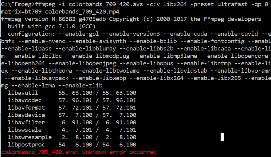

    I've been trying to run avisynth script from FFmpeg, but failed all the times.
    [Attachment 42604 - Click to enlarge]
    I've tried to use both FFmpeg 32-bits & 64-bits, and also the solution from this link, but it's still not working.
    https://stackoverflow.com/questions/29342030/error-using-avisynth-script-as-input-to-ffmpeg
    Can anyone suggest the solution?

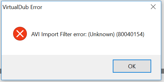

    Can't open it using VirtualDub as well
    [Attachment 42605 - Click to enlarge]
  4. If you google "virtualdub 80040154" you'll find lots of references to that error. Do you have a VFW decoder for the codec used in the AVI file? What does MediaInfo say about the AVI file?

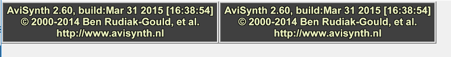

    Version()
    This code produces the same error. Let me try to reinstall my avisynth again.
    Jul 2017
    Originally Posted by sneaker View Post
    Test both VirtualDub 32 bit as well as 64 bit (like you did for ffmpeg).
    It works in VirtualDub 32.

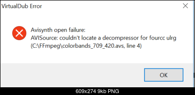

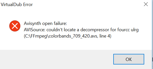

    But my script doesn't works...

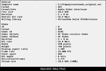

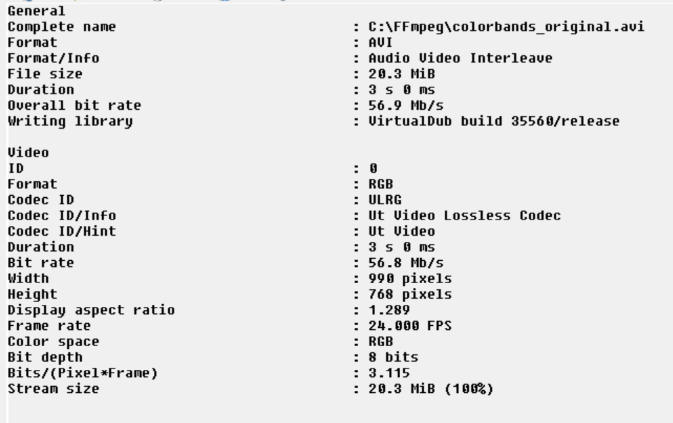

    This is what MediaInfo says:
    I install Ut Video Codec and now it works in VirtualDub. Will try it in FFmpeg.

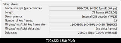

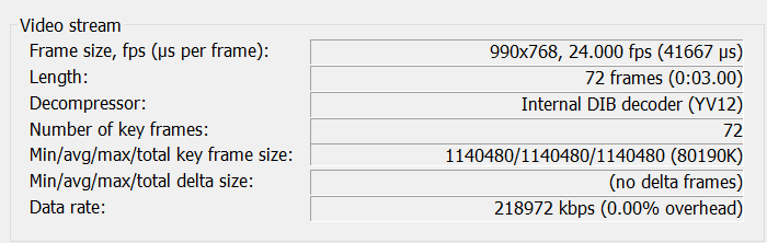

    When you open the 32bit avs in 32bit vdub, what does file=>file information say in vdub ?
    Jul 2017
    It's this error.
    File information:
  11. Are you sure that's ffmpeg 32bit binary?
    Post your full ffmpeg commandline, it looks cut off in the screenshot. Just copy & paste the text, you don't need image screenshot for that
    I renamed my ffmpeg x86 binary to ffmpeg32 to distinguish from the x64 version ,so you can call it from anywhere without mixing them up
    If you just enter
    ffmpeg32 -i "colorbands_709_420.avs"
    what does ffmpeg say ?

    C:\FFmpeg32>ffmpeg -i "colorbands_709_420.avs"
    ffmpeg version N-86383-g4705edb Copyright (c) 2000-2017 the FFmpeg developers
      built with gcc 7.1.0 (GCC)
      configuration: --enable-gpl --enable-version3 --enable-cuda --enable-cuvid --enable-d3d11va --enable-dxva2 --enable-libmfx --enable-nvenc --enable-avisynth --enable-bzlib --enable-fontconfig --enable-frei0r --enable-gnutls --enable-iconv --enable-libass --enable-libbluray --enable-libbs2b --enable-libcaca --enable-libfreetype --enable-libgme --enable-libgsm --enable-libilbc --enable-libmodplug --enable-libmp3lame --enable-libopencore-amrnb --enable-libopencore-amrwb --enable-libopenh264 --enable-libopenjpeg --enable-libopus --enable-librtmp --enable-libsnappy --enable-libsoxr --enable-libspeex --enable-libtheora --enable-libtwolame --enable-libvidstab --enable-libvo-amrwbenc --enable-libvorbis --enable-libvpx --enable-libwavpack --enable-libwebp --enable-libx264 --enable-libx265 --enable-libxavs --enable-libxvid --enable-libzimg --enable-lzma --enable-zlib
      libavutil      55. 63.100 / 55. 63.100
      libavcodec     57. 96.101 / 57. 96.101
      libavformat    57. 72.101 / 57. 72.101
      libavdevice    57.  7.100 / 57.  7.100
      libavfilter     6. 91.100 /  6. 91.100
      libswscale      4.  7.101 /  4.  7.101
      libswresample   2.  8.100 /  2.  8.100
      libpostproc    54.  6.100 / 54.  6.100
    colorbands_709_420.avs: Unknown error occurred
    Which file that I can rename? I tried to rename ffmpeg.exe to ffmpeg32.exe and run the code, but it didn't work. Did I rename the wrong file?

  13. That's the same error message you get, when there is a 32bit/64bit mismatch , eg. 64bit ffmpeg with 32bit avisynth, or 32bit ffmpeg with 64bit avisynth
    Since 32bit vdub worked, it has to be 32bit avisynth that you have installed . So I would double check your ffmpeg binary to see if it is 32bit.
    It could also be a problem with that specific binary; try downloading a different one, maybe older
