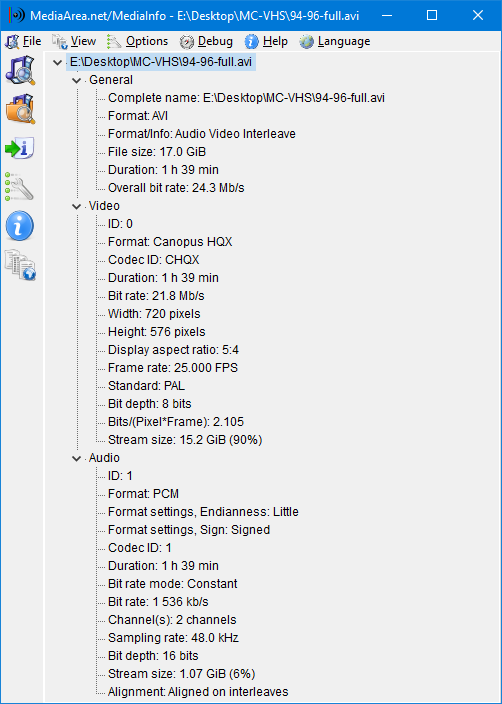

    I captured a 1h 40m VHS tape using AmaRecTV and the Grass Valley HQX codec.
    • VirtualDub-1.10.5-test7-AMD64 (October 2014) can't open the file as it just shows 'Reconstructing missing index block (aggressive mode)' and it would take a long, long time complete each time.
    • VirtualDub_FilterMod_40087_5 (July 2017) opens the file instantly but if I skip past roughly the 30,000 frame/20-minute mark, the program freezes and never re-responds.
    • AVI Splitter 2.21 (2006) shows 'Unsupported type of chunk index: 0'
    • Avidemix 2.6.21 (May 2017) freezes when I try to open the file
    Any ideas?

  2. Sounds like it's damaged
    What about a media player, like MPCHC , can you play or seek past the ~20min mark ? Also try VLC, which uses a different decoder
  3. Neowinian kingmustard123's Avatar
    Nov 2007
    PotPlayer 1.7.3344 (August 2017) only allows me to play up to the 22:00 mark.
    Can the video file be fixed?
    Was it AmaRecTV at fault?
  4. Originally Posted by kingmustard123 View Post
    potplayer, mpchc will be using the official system installed codec. Also try VLC which uses a different decoder
    Hard to say what caused it or if amarectv is at "fault" from that information alone. Maybe you had a power surge or "brown out" , just a guess
    Can you describe the physical setup ?
    You can try recovery software, or you can try recapturing, or some other method of recording
  5. Neowinian kingmustard123's Avatar
    Nov 2007
    Was a faulty file transfer (faulty USB port).
  6. >can't open the file as it just shows 'Reconstructing missing index block (aggressive mode)' and it would take a long, long time complete each time.
    If indexing completes successfully, dub to a new file using direct stream copy mode.
