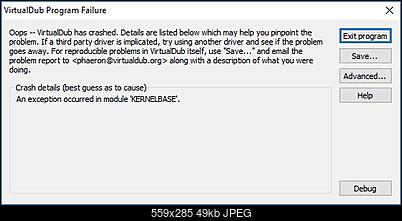

    I've hit a weird problem in Virtualdub when dealing with very large files. The input files aren't particularly big - it's the process of outputting that seems to go wrong. I originally had this problem when trying to output a 1.5hr HD file using HuffyUV. It seems that somewhere between 300-400GB it can't handle any more, and crashes. I have included a screengrab of the image below.
    I seemed to get success by using the frameserver and AVFS (as my eventual target was to convert to mp4 in handbrake) and that seemed to work for that file.
    However my latest project is having the same crashing issue, even though I'm serving using AVFS. The virtual file size in the "Volumes" folder I around 742gb. Virtualdub crashes at around 47% conversion complete, which again is in the 300-400gb range.
    Is there a known issue with virtualdub in these situations, or is it something with my set up?

    Thanks for the suggestions. Ideally I would like to "fix" what is going wrong, as I am happy with the workflow. However, I am happy to look at alternatives if necessary.
    To deal with them in order:
    1) I'm assuming this would involve actually saving the output file? One benefit from having the avfs server was to avoid taxing the HDD too much. I'd prefer to avoid creating temporary files 100's of GB in size. If I've understood you wrongly, and I don't have to actually create large temporary files please let me know
    2) I would be happy to do this, but I'm a bit of a novice with avisynth. How easy is it to replicate the settings I have created in virtualdub? I have saved the file settings, but I guess there's no easy way to import from that?
    3) I use handbrake because I have settled on processing settings I'm happy with. My OCD won't let me deal with something else doing the compression as I won't be confident it is giving me the same quality/size ratio. Sad I know, but that's just me!
