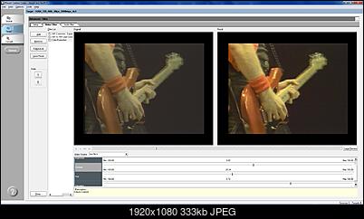

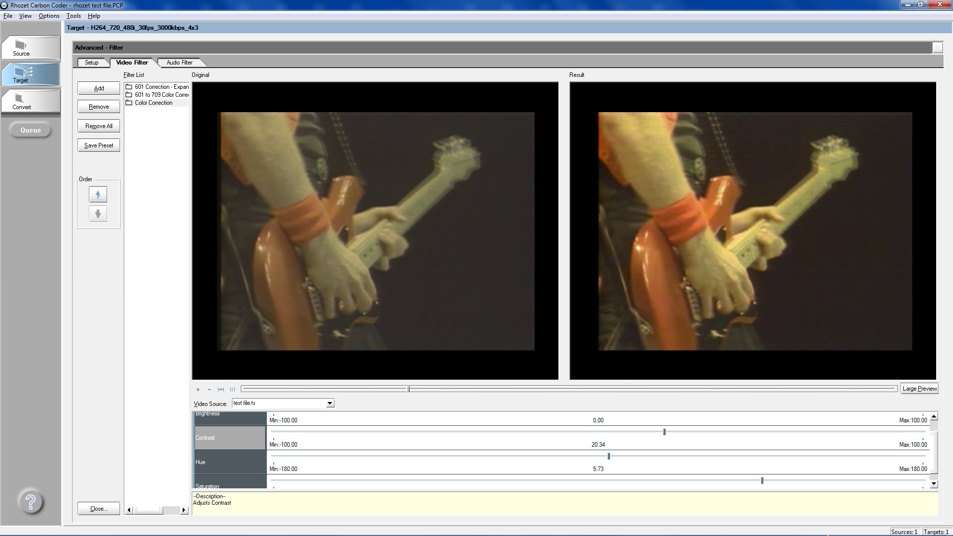

    Thanks for all the input on this topic. I really haven't had a chance to get back to this project til now. I assume it was shot on video. It's an old concert from 1982.
    I decided to re-capture it again in mpeg2 in 1hr dvd mode and I will just apply contrast,hue & saturation correction to it with Procoder. And be done with it.. 480i
    Here's an example of the difference it can make. (not final settings)

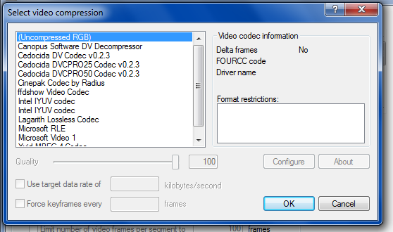

    The next step: I will apply color correction filters with Procoder 3 when encoding to mpeg2 ~ Which one of these should I compress to while doing IVTC?
    First I used uncompressed RGB and my test file grew from 500mb to 3gb. Keep it DV with one of the 1st 2 Cedocida codecs or Lagarith since it's the only one that says lossless?
    I didn't really understand, but if you're doing a series of encodes, then the intermediate files should be lossless, not uncompressed. I use Lagarith, others use UTVideo Codec, others use others. I don't filter in Procoder but use AviSynth in VDub. Only when ready for the final output format do I use something else - HC-Enc or RipBot264, usually. You certainly don't want to use uncompressed RGB. Avoid colorspace conversions whenever possible, although they might be unavoidable when doing 'color correction'. Then, minimize colorspace conversions.
