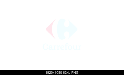

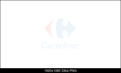

    As part of my video, at the end I need to fade in a simple logo consisting of two colours, but the two colours do not fade in at the same time in the rendered video as they do in the preview for the video editing software.
    I am using Sony Movie Studio 13, and have compressed/rendered the video using both the 'Sony AVC/MVC' render/compression option and the 'Mainconcept AVC/AAC' option, but the problem remains.
    I think I have played around with all the settings in both the codec/rendering settings windows, and with the settings within the editing interface (the events) and options too.
    What's going on? Is it something about how the H.264 codec works which means it is impossible to avoid?
    Do I need access to extra options for controlling how colours are processed in the codec options? Maybe options that would only be provided in Vegas Pro? Something to do with colour bit depth, or chroma sub sampling or something like that?
    Below are two images showing a stage of progression in the fade ins for the rendered video where the red part of the logo begins fading in first, and the preview in Movies Studio where both of the different coloured parts of the logo fade in at the same . . .

  2. Originally Posted by muel2002 View Post
    How was the fade controlled in vegas ? Was this a 1 layer , single fade setup or something else ?
    No, it's not a h264 problem (because it definitely works ok for other people), but it could be a playback setup problem.
    You probably took the screenshot in vlc (because image says vlcsnap...), and this is probably not the same frame, but there is a slight color shifting which makes me think at least partially a rec601 vs. rec709 issue
    1) What happens when you re-import the export back into vegas (instead of VLC) to check the timing and colors ?
    2) Did you try disabling GPU acceleration ? Known to cause problems in vegas. Disable in the both main settings and export settings
    3) You can export another format (e.g uncompressed RGB avi) to check and rule out h264 issue , or RGB<=>YUV issue, vs. upstream vegas problem.

  4. Uncompressed RGB test indicates no upstream problems (ie. to rule some issue with the way you setup the project, or problem importing or interpeting assets before encoding, or timing issue if you had multiple layers controlling the fade)
    Re-import of Sony AVC/mp4 test suggests export is actually fine, and that your problems are from your display configuration setup on VLC, Quicktime, YT, etc...
    Were all these tests and observations using 1920x1080 ?
    Those observations suggest it is YUV<=>RGB using wrong matrix (ie. 709/601 mismatch) on playback; or at least that's a contributing factor
    Some of the playback chain you might not be able to fully control (e.g youtube) . But HD should look right on youtube - so something is wrong if the HD version (720 and up didn't look right). It uses 709 for HD and SD, so SD should look incorrect . But sometimes if you have GPU on vs. off for web acceleration it can make a difference, or if you're using HTML5 vs. flash. And you should realize you cannot control what end users have configured for playback - the best you can do is produce proper or "correct" video . 709 is standard for HD , 601 is standard for SD.
    Basically you have to configure and fiddle with GPU settings, software settings, drivers, renderer. For each display pathway. It's better to use a test chart / known colors and do it systematically
