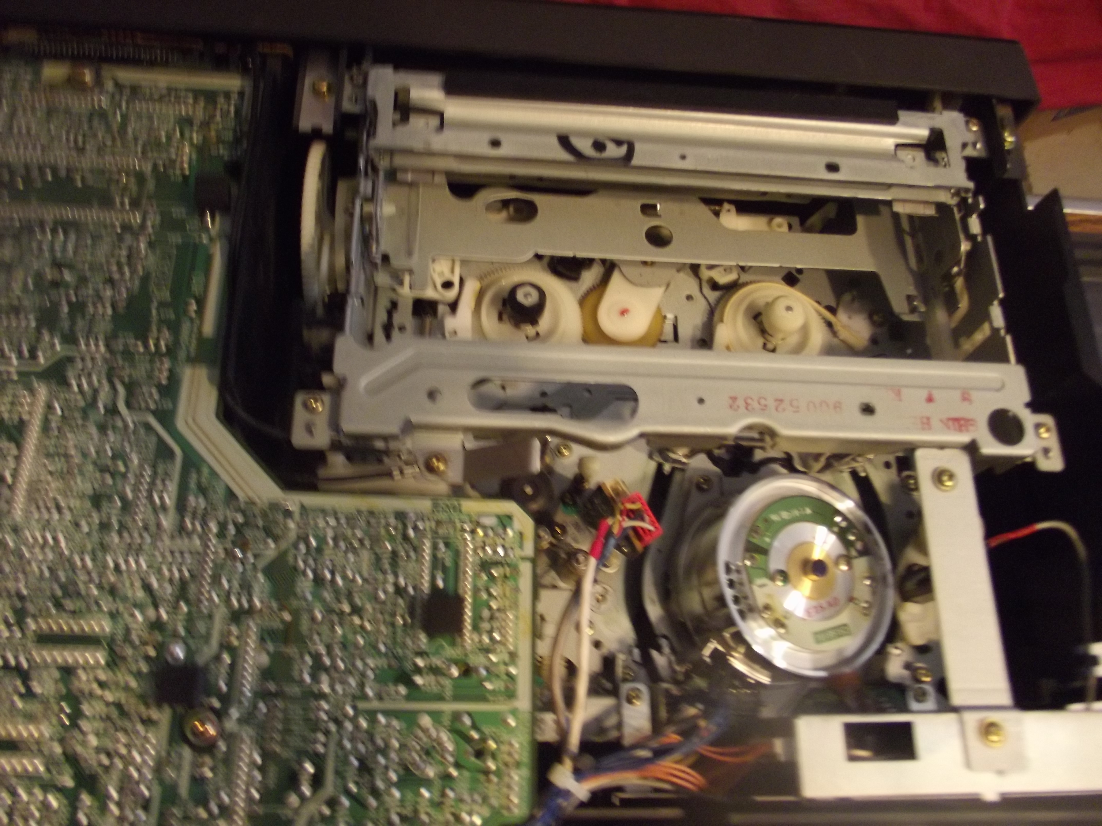

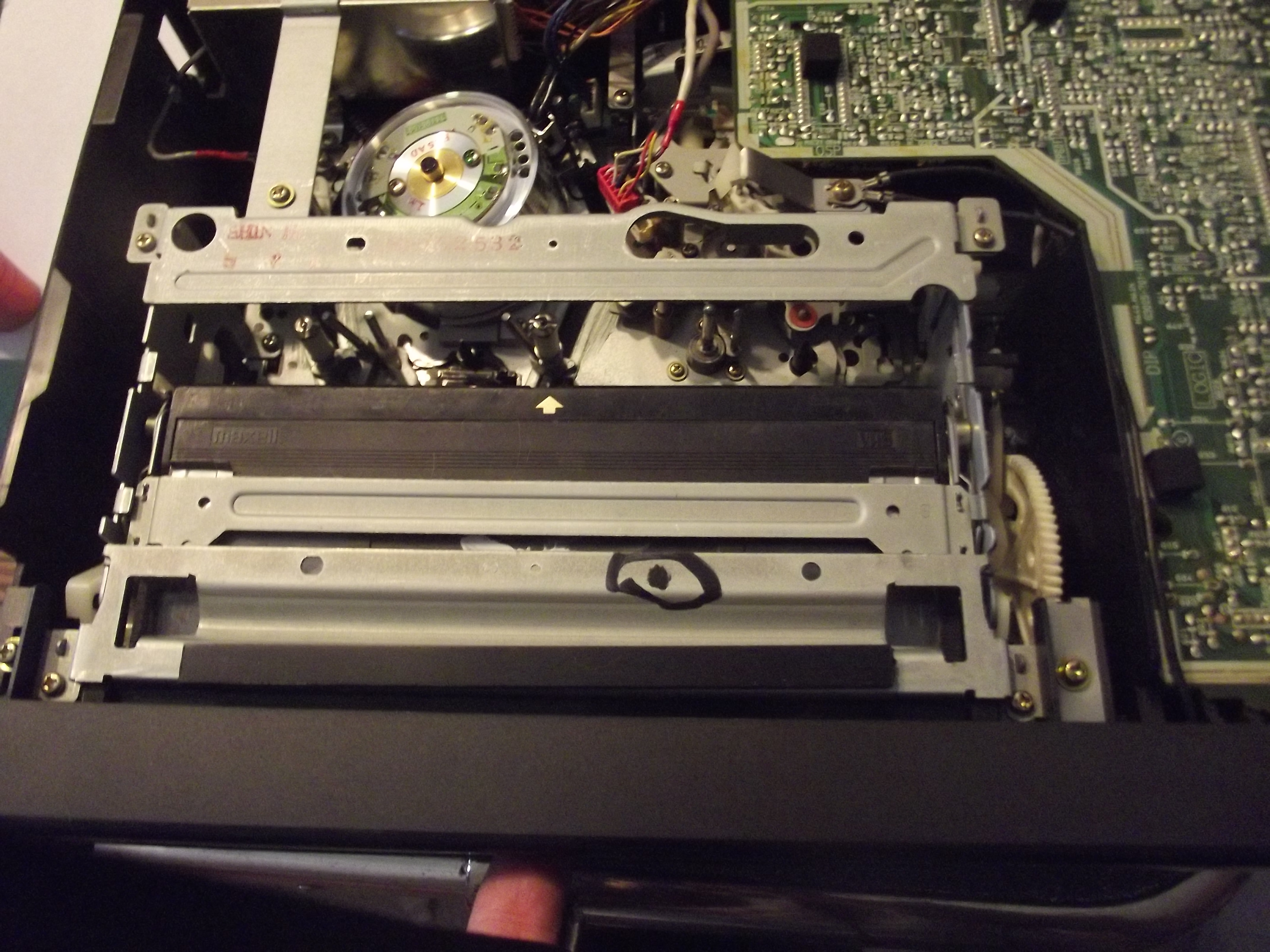

    I picked up a Toshiba M-445 VCR at a yard sale for 5 bucks, I hooked it up and turned it on. But the tape doesn't go in far enough to drop down almost feels like something is locked or blacking it from going in. anyone know what would cause that?[AImage
    [Attachment 42454 - Click to enlarge]
    TTACH]42452[/ATTACH]Image
    [Attachment 42453 - Click to enlarge]

    I had a JVC VCR with similar symptoms. I was able to fix it myself once I realized a rubber belt from a small motor
    to the load/unload mechanism had stretched. I was able to replace it restoring normal operation.
    I don't know anything about the Toshiba, chassis looks more complicated than mine.
    Good luck
  4. It is typically a timing gear problem. This is easy for a technician to fix, but very difficult for someone who doesn't have the tools or service manual.

    Find the motor which works the loader. Then, with the VCR unplugged, turn the shaft by hand and watch what happens in slow motion. You may need to remove the loader (and possibly the mechanism) to find the problem. It's probably mechanical, but could also be a faulty electronic sensor.
