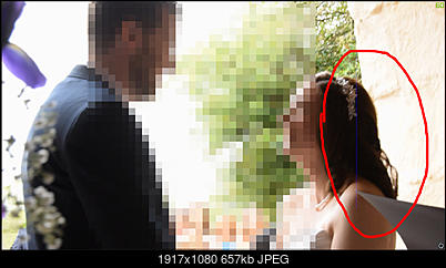

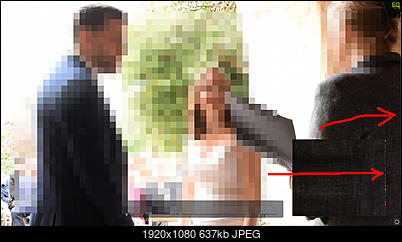

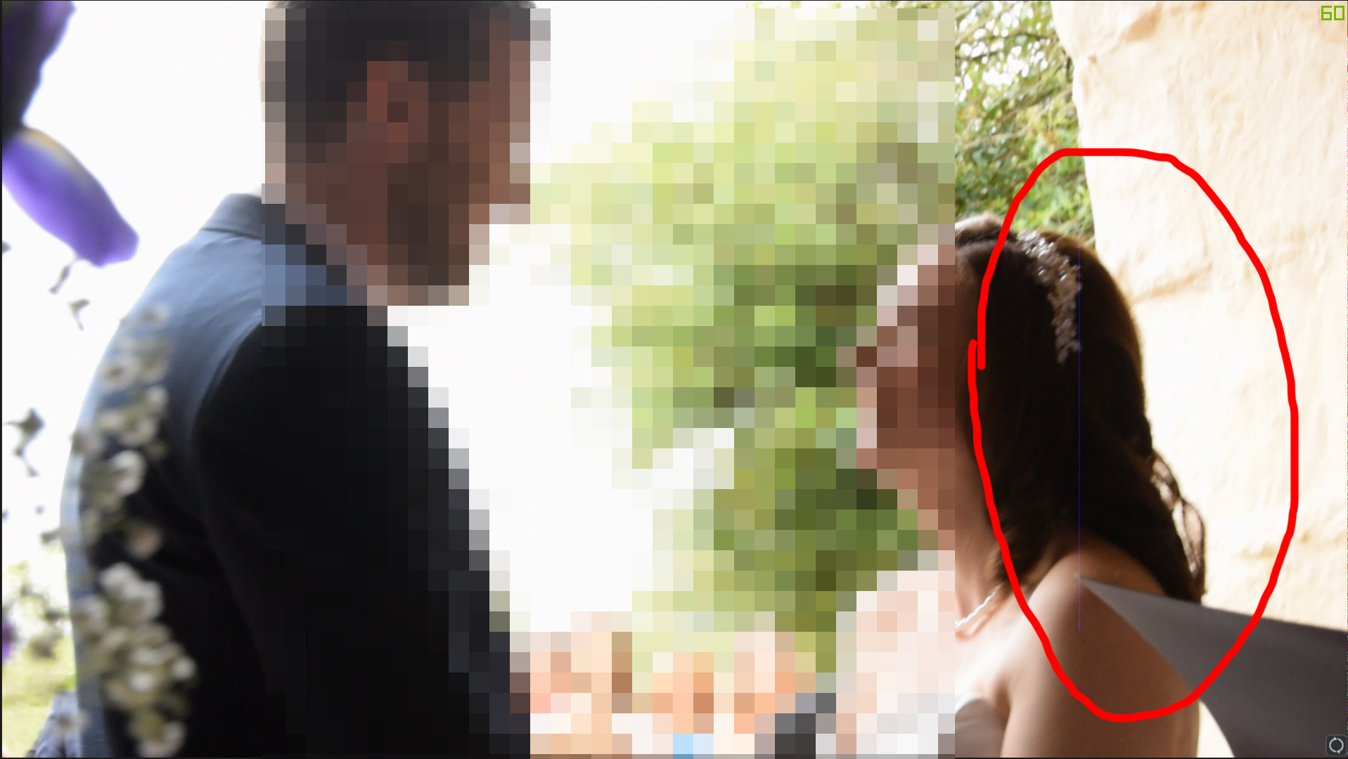

    Anyway, I'm having issues with clips that I've converting using Streamclip MPEG. The originals don't have these artifacts, but once converted, they appear. Please see sample images below:

    The file is output as .mov from Streamclip MPEG using the AVID DNxHD codec. Original footage in this case has been captured using a Nikon D3300 (25 fps), but the same artifacts appear using Geforce Experience's Shadowplay to capture game footage from screen (variables FPS, but targetted at 60).

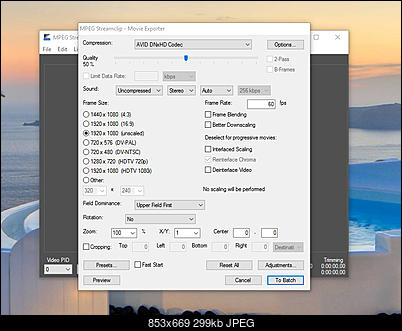

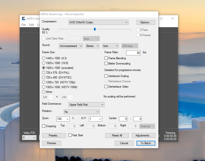

    My graphics card is a GTX-1070, and my processor is an Intel i7-6700HQ. My settings are in the photo above.
    Am I being silly here? I assume it's a simple case of changing a setting here or there, but being a novice, I'm not sure where to start.
