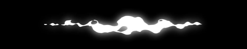

  5. I have just passed several tests, but I can not.
    The footage always plays with a background.
    ffmpeg -i input.mov -c:v libvpx-vp9 -pix_fmt yuva420p  -an output.webm
    Which app, which engine, which software, which platform do you need compatibility with ?
    vp9 supports alpha (webm), but only on some versions of chrome . Wide support for HTML5 alpha isn't there yet (use the matte hack)
    do i miss somthing in the conversion ?
    Here is the actual convertion proprety from .mov(alpha) to VP9(alpha?)
    I note that VP9 does not seem to take rgba
    -c:v libvpx-vp9 -speed 3 -threads 8 -tile-columns 6 -frame-parallel 1 -auto-alt-ref 1 -lag-in-frames 25 -aspect 5 -an -y -hide_banner
    here the code i use to insert video in the projet
    var videoTexture = PIXI.Texture.fromVideo('video/3e453h.webm'); // video dir
            var vidControl = videoTexture.baseTexture.source; //control video
            var videoSprite = new PIXI.Sprite(videoTexture); // inject video in sprite
    i have acces to some method here
    https://developer.mozilla.org/en-US/docs/Web/API/HTMLMediaElement
    I do not know if it's a property that needs to be activated, or just my conversion that is not good.
    thank a lot for help
    here the original file .mov, if soem can try to get alpha with.
    https://mega.nz/#!9AghRRzC!rSRuDAYw8ZBnrWXFDLizHDZfO65SSkTafcFmybfEIIA

  7. Yes, only yuva420p (4:2:0 subsampled with alpha) is supported, not RGBA . You might need to specify -pix_fmt yuva420p explicitly as in the example commandline above, staxrip might have discarded the alpha
    vp9 with valid alpha works in FF 53+ ok
    ffmpeg -i "test alpha fire.mov" -pix_fmt yuva420p -c:v libvpx-vp9 -crf 18 -b:v 0 test_alpha_fire.webm

    Oh thank a lot friend!, your file work in my project. !!!
    But I just test your command line above, and unfortunately it does not work.
    How have you perform this in this software.
    I started learn staxrip , so I confessam little bite lost one !!
    It would be really great if you could guide me.
    i need to put the command line here ?

  10. Originally Posted by poisondeathray View Post
    It might be that the bundled ffmpeg version 3.3.2 in staxrip isn't using up to date libvpx
    ok i just got download last one and replace the ffmpeg.exe by the new version.
    in \StaxRip-x64-1.5.0.0\Apps\ffmpeg
    but not seem work, i have alway black background after encode

    i add file Befor .Mov
    and after .webm
    .webm not have alpha work !

  29. also check the avs script
    Find the location where it's saved
    Add ShowAlpha() , and save it with different name , like test.avs
    LoadPlugin("C:\Users\jonle\APP Portable\StaxRip-x64-1.5.0.0\Apps\Plugins\avs\L-SMASH-Works\LSMASHSource.dll")
    LSMASHVideoSource("C:\Users\jonle\Desktop\testFire01.mov")
    BicubicResize(992, 192, 0, 0.5)
    ShowAlpha()
    open test.avs in vdub, do you see white/black alpha like in AE ?
    it should look something like this when you view the alpha directly. If it does, there is nothing wrong with your avisynth install, or your lsmash version, and the problem is downstream, such as ffmpeg version, or libvpx version
    [Attachment 42476 - Click to enlarge]
