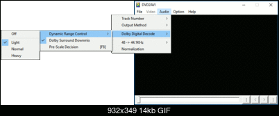

    In DVD2AVI you have 4 options about this:
    Dynamic Range Control being set to "Off" is the best for music DVDs, however regularly that will cause clipping because the volume gains too loud. You can prevent clipping by switching the Normalisation-option on. After selected the right settings but before running the operation you have to run a Pre-Scale Decision. (By Dolby Digital and DTS you always have to do that.) In most cases the Pre-Scale Decision will last for quite a short time, though it will give a better audio quality. You can convert the samplerate from 48000 to 44100. By setting the convertion-option to UltraHigh the sound quality is the best and the audio track remains synchronized with the videotrack.
    For movies the Dynamic Range Control being set to "Off" causes soundtracks and ambient sounds being too dominant. In the included TXT-file it is said the best option for movies is the DRC being set to "Normal". However personally I always try if the option "Light" is sufficient.
    In case of Dolby Surround select the option Dolby Surround Downmix.
    Despite the option in the menu File > Process WAV I cannot manage to extract a WAV-file only. To obtain a file of the audio you have to convert the video as well. For that I use the crop-option to make the image size as small as possible and for convertion I select a fast lossless codec. DVD2AVI splits the videotrack and audiotrack in two separate files. After the operation I remove the videotrack.
    I will get a good quality audio-track, however using DVD2AVI only for this makes it quite complicated, because I also need to do the video-editing as well.
    What are the options to do this more easily and remain control about the dynamic range?
