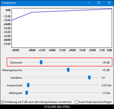

    • Use default settings, except for the first option in the list, as shown in the screenshot (says something like 'limit' or 'limiter'; note: screenshot taken from the German version of Audacity).
    • Push the slider of that option to the extreme left, as shown, so the curve in the little diagram is almost level with the upper box margin.

    Audacity Compressor setting:

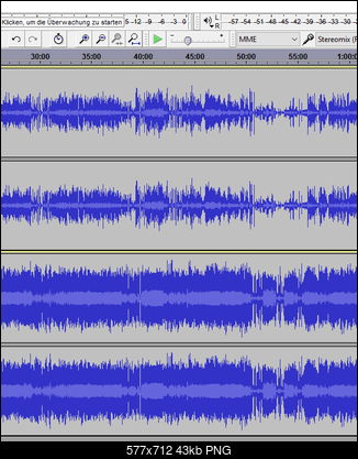

    Sample view of audio before and after applying compressor:
    As visible in the screenshot this method does not level out all dynamics completely, which one wouldn't want. But sliding the switch of that option in Audacity to somewhere on the extreme left takes care of a lot.

    • The channels themselves, if converted to stereo, usually look like the 'before' stream in the sample screenshot I included, therefore 'levelling out' those high dynamic ranges makes sense. In my case.
