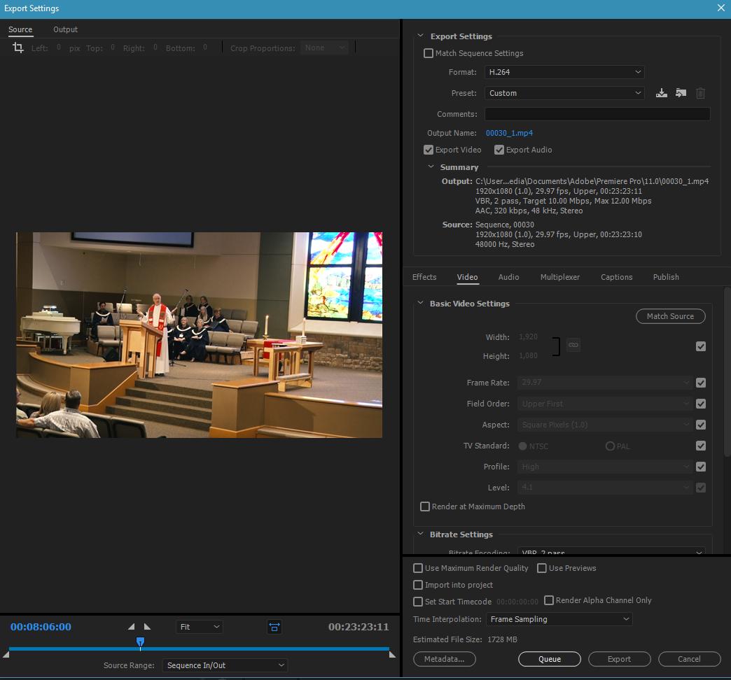

    After the post production is completed, the videos are taking a little over an hour to encode or sometimes even a couple. Based on the specs of my computer below, are these the results I should be getting? I use Premiere Pro CC and all of the videos I shoot are 1080p 60fps. I realize that shooting at a lower resolution would speed up the process, I just want some opinions on the computer I built from a video editing perspective. I built the computer from the perspective of a Computer Science major, as opposed to someone who knows video editing.

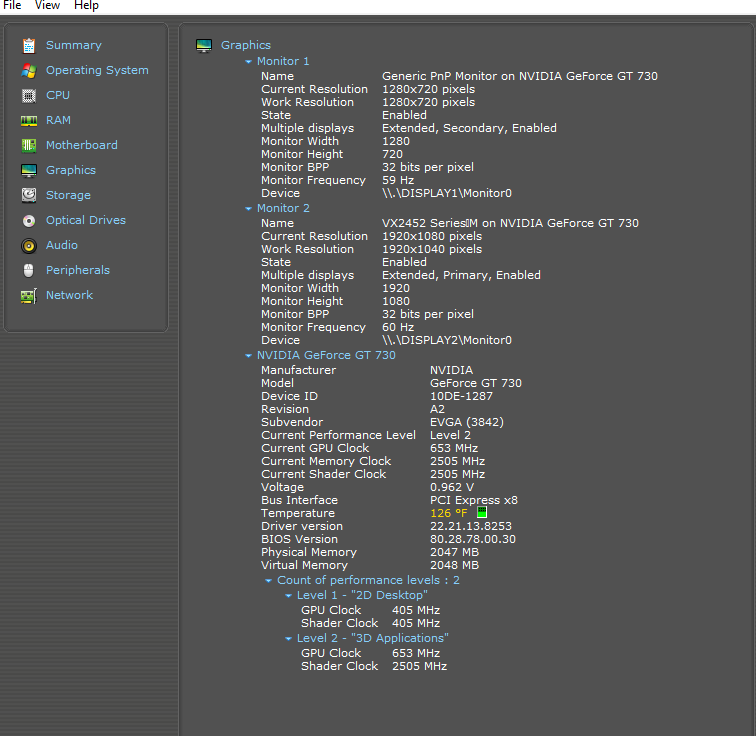

    Important note: I had to return the firepro W4100 since they weren't compatible with another program I run. If you have any suggestions for a replacement I'd welcome any ideas. I'm using a NVIDIA GeForce GT 730 as a temporary replacement until I get some opinions from knowledgeable people such as yourselves.

Name:	Premiere Export Settings.jpg
