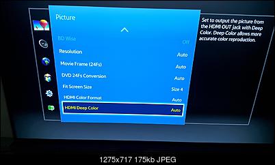

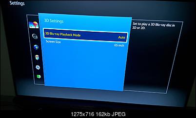

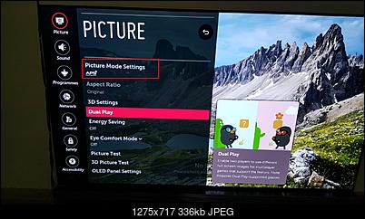

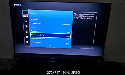

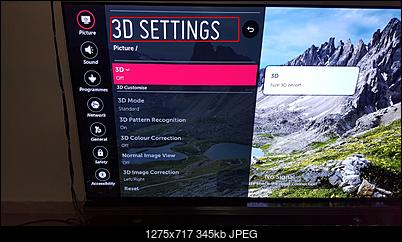

    i have issues with my 3D viewing.. so, that's why i seek some expert's suggestion.
    Sir, i have purchased a very high end (award winning top model of 2016) LG OLED65G6T 65inch TV. (9999AUD)
    and also purchased best 4k blu-ray player Samsung UBD-K8500. (299USD)
    now when i tried to view 3D movies on my my player. It seems to me i am not getting perfect/actual 3D effect.
    In some cases depth seems to be fine but there is no (very hard to find out) pop-out (by pop-out i mean it's looks like something getting out of TV screen).
    I hope i don't have to explain what is pop out effect as almost every 3D fans knows what is it.
    I purchased original 3D blu-ray disc just to get best 3D and picture quality . but i am not getting it.
    so, i can't figure out where is the problem is it on my TV setting issue or the player setting issue.

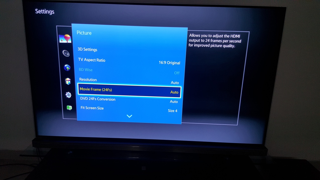

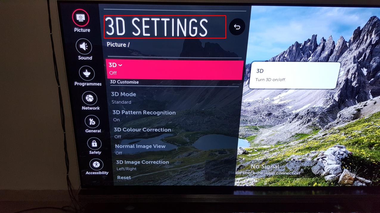

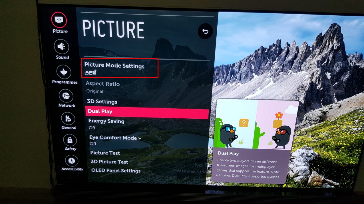

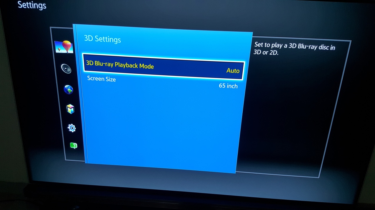

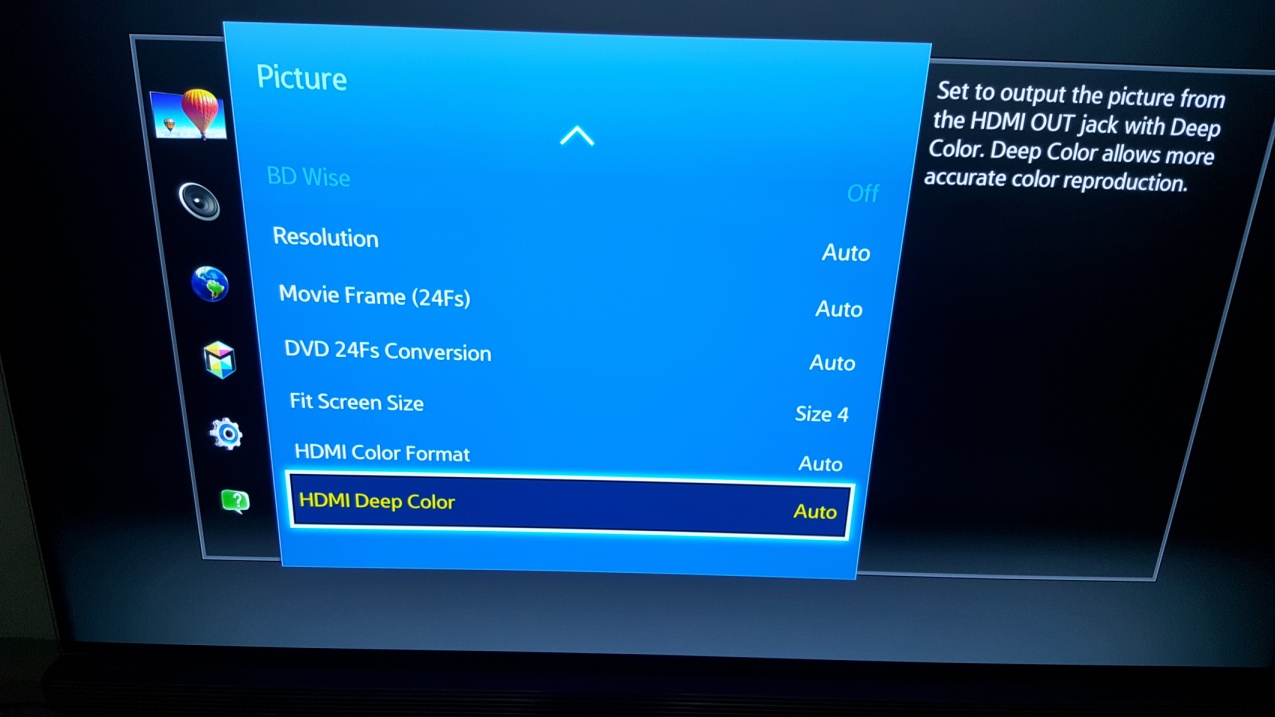

    i have attached both (TV And 4K Player) settings picture/shot.
Name:	4k Player Config-1.jpg
Name:	TV Config-2.jpg

Name:	4k Player Config-2.jpg

Name:	4k Player Config-3.jpg

Name:	TV Config-1.jpg

    FYI: 1. I have set HDMI Deep Color on, though i even tried with DEEP Color OFF. No difference.
    2. There is a option to convert frames 24 to get better quality, i don't know whether that one is the culprit..

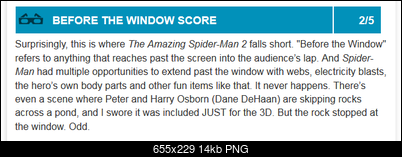

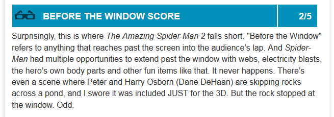

    spiderman 2 does not have much in the way of 3d things popping out of the screen. you can check which movies have good 3d effects at http://www.cinemablend.com/3d?ss52uQ_page=1
    there are no adjustments that will make things look more 3d. you get whatever the producer put in the movie, or nothing at all...

  5. aBigMeanie aedipuss's Avatar
    Oct 2005
    666th portal
    in your settings picture you have 3d set to "dual play" - that's only for using the tv for 2 player games. try clicking the reset 3d settings button and try the stock settings.
