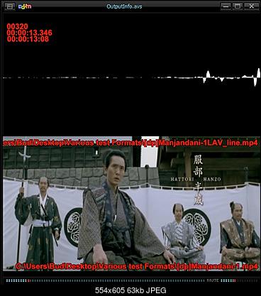

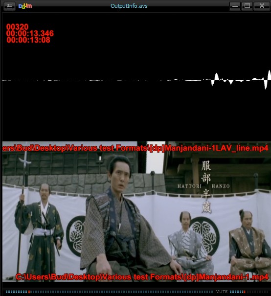

    Looks like MPC-HC is the way to go for ease of operation but for a visual display, I often use 2 different ffmpeg methods. For anyone interested in a programmatical method:
    1. Create a line graph video of the audio and compare them
    ffmpeg -f lavfi -ss 00:00:00.000 -i "amovie='C\:\\Users\\Bud\\Desktop\\Various test Formats\\[dp]Manjandani-1.mp4',asplit[out0],showwaves=r=23.976:s=704x320:mode=line[out1]" -r 23.976 -s 704x320 -vcodec libx264 -vsync 1 -y "C:\Users\Bud\Desktop\Various test Formats\[dp]Manjandani-1LAV_line.MP4"
    Then use avisynth to stack them:
    v1=DirectShowSource(("C:\Users\Bud\Desktop\Various test Formats\[dp]Manjandani-1.mp4"), Pixel_Type="yuy2").Crop(0,0,-0,-0)
    v2=DirectShowSource(("C:\Users\Bud\Desktop\Various test Formats\[dp]Manjandani-1LAV_line.mp4"), Pixel_Type="yuy2").Crop(0,0,-0,-0)
    stackvertical(v2, v1)
    Subtitle("C:\Users\Bud\Desktop\Various test Formats\[dp]Manjandani-1LAV_line.mp4", font="Arial", size=24, text_color=$ff0000, align=6)
    Subtitle("C:\Users\Bud\Desktop\Various test Formats\[dp]Manjandani-1.mp4", font="Arial", size=24, text_color=$ff0000, align=3)
    ShowFrameNumber(scroll=true, x=10, y=27, font="Arial", size=24, text_color=$ff0000)
    ShowTime(x=72, y=44, font="Arial", size=24, text_color=$ff0000)
    ShowSMPTE(fps=23.976, x=68, y=61, font="Arial", size=24, text_color=$ff0000)

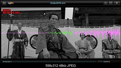

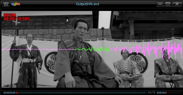

    2. Use Audiograph to display overlay of audio
    DirectShowSource(("C:\Users\Bud\Desktop\Various test Formats\[dp]Manjandani-1.mp4"), Pixel_Type="yuy2").Crop(0,0,-0,-0).DelayAudio(-0.0).AudioGraph(2)
    LanczosResize(864,368)
