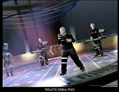

    I recently got my hands on an old Panasonic AG-MD835 unit and was doing some initial testing against my other Panasonic AG-5260. I was planning on doing a small write up on the unit as there is little to no information on it, but ran into an issue that is appearing in the video output. I'll provide frame output comparisons as well as the full clips for review below.
    The first test is the AG-MD835 connected through the DMR-ES10, using composite outputs for A/V from the VCR and S-Video from the DVD Recorder.

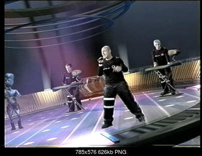

    The second test is the AG-MD835 using S-Video for the output however NOT run through the DMR-ES10
Name:	Test 2 snap.png

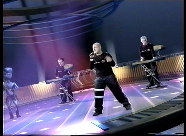

    The last test is the AG-5260 running through the DMR-ES10, using composite outputs for A/V from the VCR and S-Video from the DVD Recorder.

    My opinion on the few results is that the AG-5260 has a far superior output, the colours appear to be much richer as well having an overall less noisy image. The differences between the first two situations are basically none from what I can see, however I would have thought that the AG-MD835 would have at least provided a similar quality if not better image.
    My thoughts are that something is up with the unit, I haven't inspected it since I have purchased it but I do know that it was removed from a good working environment only recently and has less than 500 total hours. I'm not really well versed on VCR issues and the only things that spring to mind is either a dirty head or components otherwise, or something in the circuitry like the built in Line-TBC failing.
    I would like to get a general idea of what to start looking for, or if this is simply just a normal difference between two different VCR's.
    Note - The original test clip pertains to the last frame test and the other clip belongs to the first test (Second test clip not included).

    Were both decks in the same noise reduction mode? In other words, both have to be in EDIT mode or out of EDIT mode for a valid comparison.
    Jun 2017
    Australia
    The only option that should really make a difference in either of these tests is the Y/C filter on the AG-MD835, however for some reason it's called something different. I could only find a NTSC version of the manual which states this setting is a Y/C filter, the first two tests on this unit compare the difference. The first test is the exact same config as the AG-5260 and the second config is using the S-Video with what I'm guessing is the Y/C filter. When I get a chance I'll check what it is called in the menu as I can't remember off of the top of my head. As for any sort of "Editing Mode" I don't believe either of these units have anything like that.
    For reference the AG-5260 has no configurable menu options, and like previously stated the only option that can be configured in the video signal for the AG-MD835 is the Y/C filter.
    EDIT - Where the Y/C filter is in the NTSC manual on the PAL unit is called "Notch", whatever that means. Also on that same menu is the "Edit Mode" option which has been set to off and all of the tests will have been done with that off.
