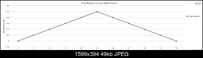

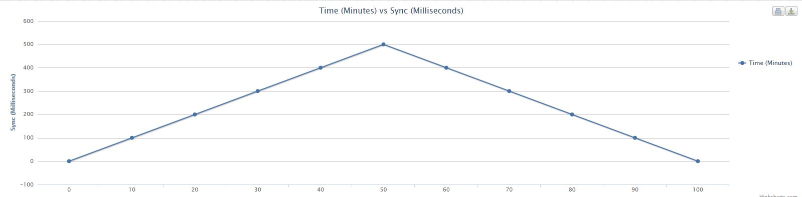

    Also, just to be clear, the sync doesn't drift. As I described earlier, the audios and videos are the same length so I don't think it's a framerate issue, and the lack of sync follows a pattern so it's not a matter of a simple, constant delay. Here's a crude example for a 100 minute long movie:

  9. Originally Posted by LouieChuckyMerry View Post
    [Attachment 42311 - Click to enlarge]
    Right, that's drift. All "drift" implies is progressively worsening audio desync with respect to picture (ie. not a constant offset). Anytime you have drift, it usually means A/V length mismatch. That's what you have, when you look at each section.
    Think of it this way: if you have a progressively worsening +ms audio delay up to the inflection point, this means audio comes after the picture and is getting worse until that point, where it's most severe. If you were to cut the video right at that point - the matching audio would be too short and cut off. If you included the matching audio that corresponds to the full picture, it would be longer than the video. Thus you would need to "shrink" that 1st part so it matches.
    It's exactly the reverse for the "2nd half" . At the inflection point, the audio is already + delayed compared to picture, but at the very end eventually becomes in sync. Thus, if you look at the "2nd half" and cut the picture - you have too much audio from the previous section. If you were to include only the audio corresponding to the picture for that half, it would be shorter than the video. Thus you "stretch" that part to match up.
    Schematically it might look like this (exagerrated) illustration. The top is the video, bottom is the audio
    If it was the opposite direction, then stretch the first, shrink the 2nd - the concept is the same.
    You don't have to physically split the video . And it's not physically split into files, it's done on the GUI timeline which only references the actual audio & video . But you do have to divide up the audio to process in sections (I mean on the timeline) . I don't know of any good freeware NLE's that can do this type of work well, but this is what I was taking about in my earlier replies. You only have "2" sections - which I would consider good fortune instead of 100 little sections. You can try JVRaines' suggestion, but this type of work is usually done in a NLE, where you can "see" the video and manipulate audio at the same time on the fly
