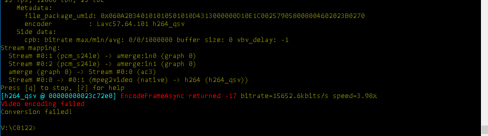

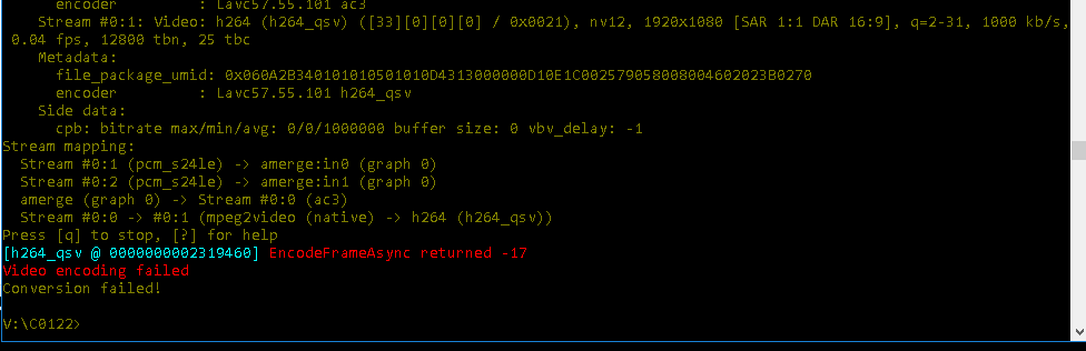

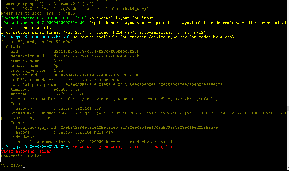

  9. I have test h264_qsv over a single file (not concat), over an .avs and in all cases in single true video files but ... the same problem: it return an error, sometime works, sometimes frezze randomly.
    Also I have remove the -threads 12 from commandline, but the problem remains
    [Attachment 42339 - Click to enlarge]
    [Attachment 42340 - Click to enlarge]
    [Attachment 42341 - Click to enlarge]

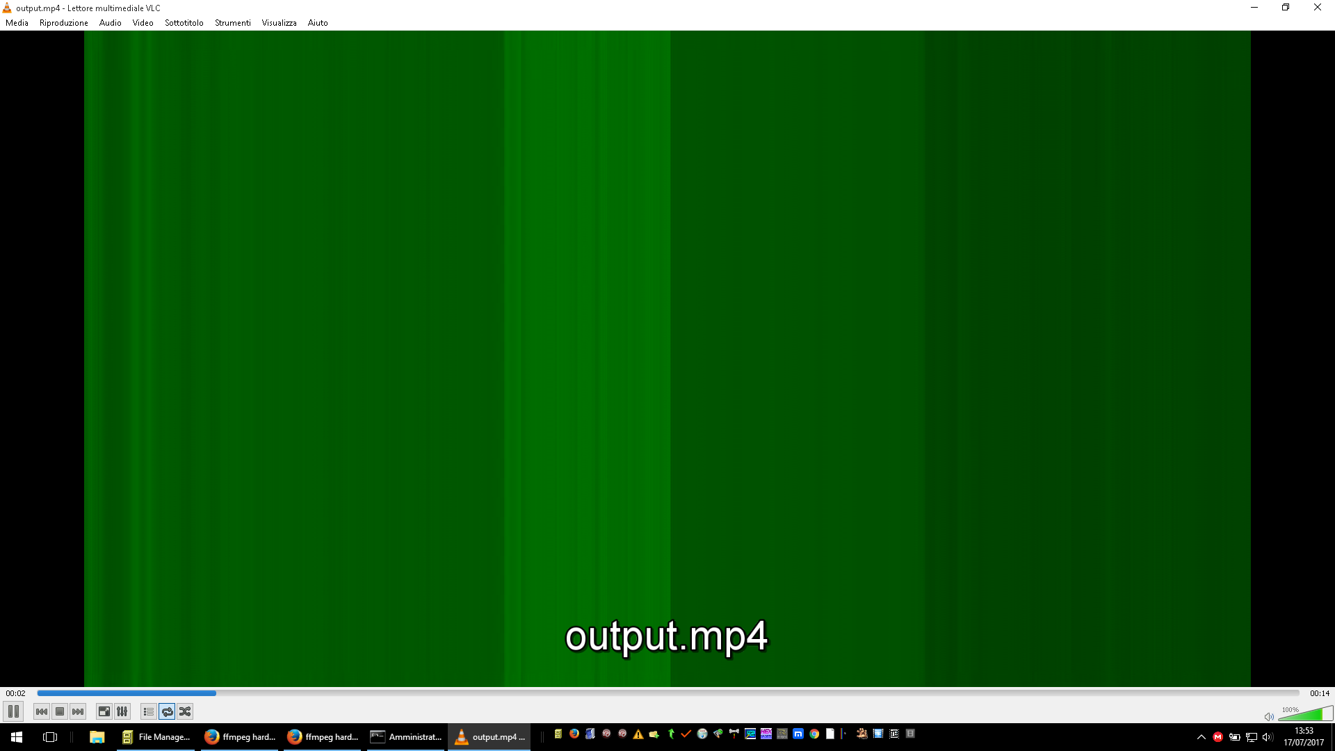

  14. I have try the commandline
    ffmpeg64bitjuly2017 -i c0113.mxf -vf scale=interl=1,format=pix_fmts=yuv420p -c:v rawvideo -an -f rawvideo - | QSVEncC64.exe --raw --input-res 1920x1080 --fps 25 -i - --tff --la-icq 24 -o output.mp4
    without the --codec h264 otherwise:
    QSVEncC.exe --input-res 1920x1080 --fps 25 -i c0034.avs --codec h264 --tff --la-icq 24 -o output.mp4
    Error: Unknown value for codec
    so what version of QSVEncC.exe/QSVEncC64.exe are you using?
    However removing "--codec h264" from the commandline the pipe generate the final output but in VLC won't play. Also using the 32 bit version
    where C0034.avs is:
    LoadPlugin("C:\staxrip\Applications\AviSynth plugins\ffms2\ffms2.dll")
    FFVideoSource("V:\C0122\C0034.MXF", cachefile = "V:\C0122\C0034 temp files\C0034.ffindex")
    AssumeFPS(25.000000)
    ConvertToYV12()
    I attach the output.mp4 here

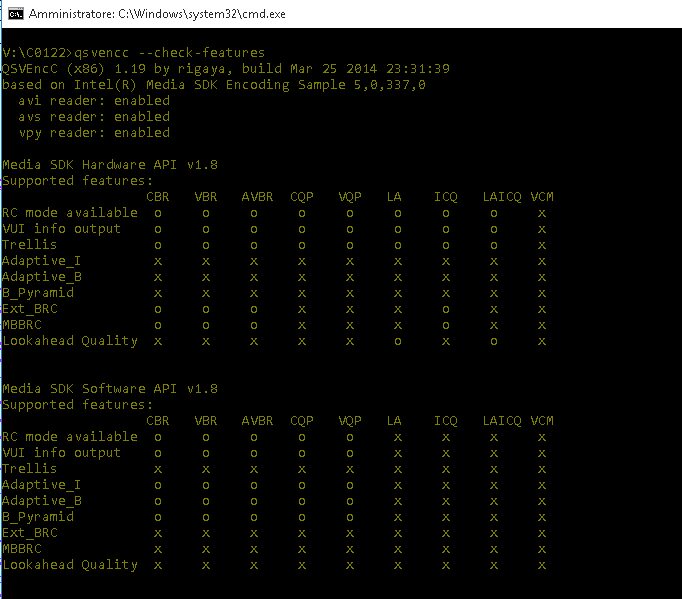

    qsvencc --check-features 1>features.txt
    QSVEncC (x86) 1.19 by rigaya, build Mar 25 2014 23:31:39
    based on Intel(R) Media SDK Encoding Sample 5,0,337,0
    avi reader: enabled
    avs reader: enabled
    vpy reader: enabled
    Media SDK Hardware API v1.8
    Supported features:
    CBR VBR AVBR CQP VQP LA ICQ LAICQ VCM
    RC mode available o o o o o o o o x
    VUI info output o o o o o o o o x
    Trellis o o o o o o o o x
    Adaptive_I x x x x x x x x x
    Adaptive_B x x x x x x x x x
    B_Pyramid x x x x x x x x x
    Ext_BRC o o o x x x o x x
    MBBRC o o o x x x o x x
    Lookahead Quality x x x x x o x o x
    Media SDK Software API v1.8
    Supported features:
    RC mode available o o o o o x x x x
    VUI info output o o o o o x x x x
    Trellis x x x x x x x x x
    Adaptive_I o o o o o x x x x
    Adaptive_B o o o o o x x x x
    B_Pyramid o o o o o x x x x
    Ext_BRC x x x x x x x x x
    MBBRC x x x x x x x x x
    Lookahead Quality x x x x x x x x x

    Where source422 is this usual MXF:
    https://www.dropbox.com/s/829iziwuetpdqm4/source422.MXF?dl=0
    I try:
    ffmpeg64bitjuly2017 -i source422.mxf -vf scale=interl=1,format=pix_fmts=yuv420p -c:v rawvideo -an -f rawvideo - | c:\q\QSVEncC\x86\QSVEncC.exe --input-res 1920x1080 --fps 25 --raw -i - --codec h264 --tff --la-icq 24 -o output.mp4
    but output.mp4 is the attached green screen
    [Attachment 42354 - Click to enlarge]
    maybe a wrong little parameter in the pipe?
  16. I used 2.62 . Works here. Maybe problem with your driver / version mismatch ?
