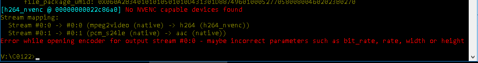

  10. exactlly I don't why but yesteday the -c:v h264_nvenc works, and today I get this error
    [Attachment 42287 - Click to enlarge]
    using:
    ffmpeg.exe -y -i c0113.mxf -vf scale=interl=1 -c:v h264_nvenc out.mp4
  11. Copy&paste the complete ffmpeg log. Is the source not 4:2:0 while ffmpeg's Nvidia encoder only supports 4:2:0 or something like that?
  12. You have a notebook, don't you - and doesn't the nVidia notebook GPU shut down (reverting to CPU graphics) sometimes to save power? If so, you might want to force the GPU to stay active when connected to AC power, using power profiles.
  13. Originally Posted by sneaker View Post

  14. Originally Posted by raffriff42 View Post
    I dont' know but not sure is a problem of the power profile however I keep alwais the maximum power in the pc using
    powercfg.exe /setactive 8c5e7fda-e8bf-4a96-9a85-a6e23a8c635c
  15. Originally Posted by sneaker View Post
    oh I think you are right cat

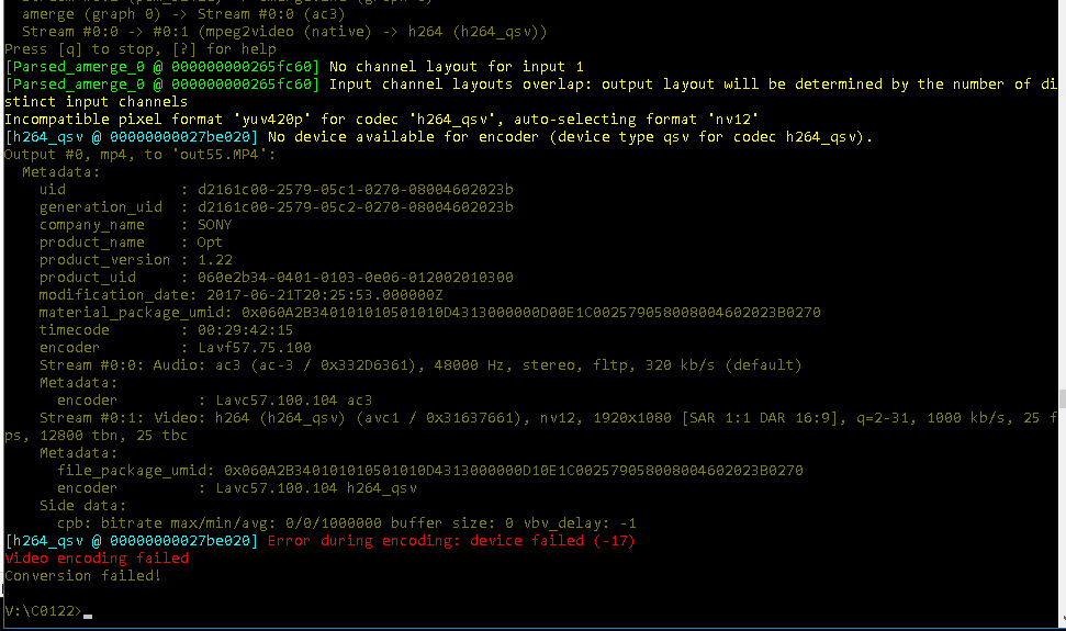

    In the meantime I have try also the QSV encoder that seems resolve the problem of the "out of color"
    ffmpeg64bitsett2016.exe -threads 12 -y -i c0113.mxf -filter_complex "[0:1] [0:2] amerge" -pix_fmt yuv420p -vf scale=interl=1,format=pix_fmts=yuv420p -c:v h264_qsv -global_quality 27 -level:v 4.1 -flags +ildct+ilme -top 1 -c:a ac3 -b:a 320k -ar 48000 -aspect 16:9 out56.MP4
    but randomly I get this error
    [Attachment 42308 - Click to enlarge]

    Stream #0:1: Audio: pcm_s24le, 48000 Hz, 1 channels, s32 (24 bit), 1152 kb/s
    Metadata:
    file_package_umid: 0x060A2B340101010501010D431301D8874960100052770580 08004602023B0270
    Stream #0:2: Audio: pcm_s24le, 48000 Hz, 1 channels, s32 (24 bit), 1152 kb/s
    Metadata:
    Stream #0:3: Audio: pcm_s24le, 48000 Hz, 1 channels, s32 (24 bit), 1152 kb/s
    Metadata:
    Stream #0:4: Audio: pcm_s24le, 48000 Hz, 1 channels, s32 (24 bit), 1152 kb/s
    Metadata:
    Stream #0:5: Audio: pcm_s24le, 48000 Hz, 1 channels, s32 (24 bit), 1152 kb/s
    Metadata:
    Stream #0:6: Audio: pcm_s24le, 48000 Hz, 1 channels, s32 (24 bit), 1152 kb/s
    Metadata:
    Stream #0:7: Audio: pcm_s24le, 48000 Hz, 1 channels, s32 (24 bit), 1152 kb/s
    Metadata:
    Stream #0:8: Audio: pcm_s24le, 48000 Hz, 1 channels, s32 (24 bit), 1152 kb/s
    Metadata:
    [Parsed_amerge_0 @ 00000000022c5480] No channel layout for input 1
    [Parsed_amerge_0 @ 00000000022c5480] Input channel layouts overlap: output layout will be determined by the number of distinct input channels
    Incompatible pixel format 'yuv420p' for codec 'h264_qsv', auto-selecting format 'nv12'
    [mp4 @ 00000000022e3b00] Using AVStream.codec to pass codec parameters to muxers is deprecated, use AVStream.codecpar instead.
    Last message repeated 1 times
    Output #0, mp4, to 'out56.MP4':
    Metadata:
    uid : d9611000-5277-05c1-0270-08004602023b
    generation_uid : d9611000-5277-05c2-0270-08004602023b
    company_name : SONY
    product_name : Opt
    product_version : 1.22
    product_uid : 060e2b34-0401-0103-0e06-012002010300
    modification_date: 2016-12-30T11:55:30.000000Z
    material_package_umid: 0x060A2B340101010501010D4313000000549A160016780580 08004602023B0270
    timecode : 00:29:35:14
    encoder : Lavf57.48.103
    Stream #0:0: Audio: ac3 ([165][0][0][0] / 0x00A5), 48000 Hz, stereo, fltp, 320 kb/s (default)
    Metadata:
    encoder : Lavc57.55.101 ac3
    Stream #0:1: Video: h264 (h264_qsv) ([33][0][0][0] / 0x0021), nv12, 1920x1080 [SAR 1:1 DAR 16:9], q=2-31, 1000 kb/s, 0.04 fps, 12800 tbn, 25 tbc
    Metadata:
    encoder : Lavc57.55.101 h264_qsv
    Side data:
    cpb: bitrate max/min/avg: 0/0/1000000 buffer size: 0 vbv_delay: -1
    Stream mapping:
    Stream #0:1 (pcm_s24le) -> amerge:in0 (graph 0)
    Stream #0:2 (pcm_s24le) -> amerge:in1 (graph 0)
    amerge (graph 0) -> Stream #0:0 (ac3)
    Stream #0:0 -> #0:1 (mpeg2video (native) -> h264 (h264_qsv))
    Press [q] to stop, [?] for help
    [h264_qsv @ 00000000025a3560] EncodeFrameAsync returned -17
    Video encoding failed
    Conversion failed!

    Did you try update intel driver for QSV ? Are you using other application that is accessing QSV at same time ?
    Have you ever been able to successfully encode using ffmepg QSV ? Did you try rigaya's QSVENCC? If you can encode with that you know it's not a hardware/driver issue

    ffmpeg64bitjuly2017.exe -threads 12 -y  -i source422.mxf -pix_fmt nv12 -vf scale=interl=1,format=pix_fmts=nv12 -c:v h264_nvenc -preset slow -cq 20 -qmin 10 -qmax 26 -refs 4 -profile:v high -level:v 4.1 -flags +ildct+ilme -top 1 -aspect 16:9 -an NVENC.MP4
    file size is alwais 22MB. Quality is not bed but in the frame by frame comparison, seems that there is too many loss of details.
    If I try to add -rc-lookahead 16 in the commandline I get [h264_nvenc @ 00000000023ac520] No NVENC capable devices found
    However the problem is the loss of details
    So is there a way to improove the quality of this NVENC encoding? thanks

    If I try to add [B
    -rc-lookahead 16[/B] in the commandline I get [h264_nvenc @ 00000000023ac520] No NVENC capable devices found
    Your GT 750M is first gen nvenc so it may not support some options, also quality wasn't very good with Kepler GPUs.
