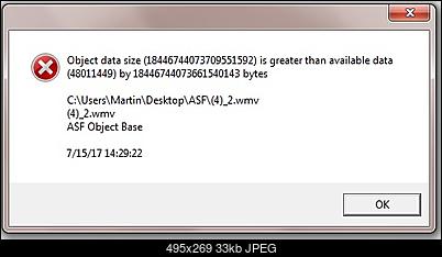

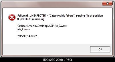

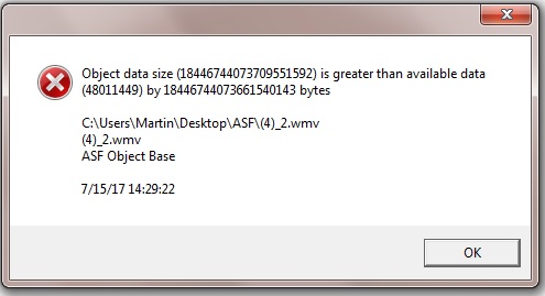

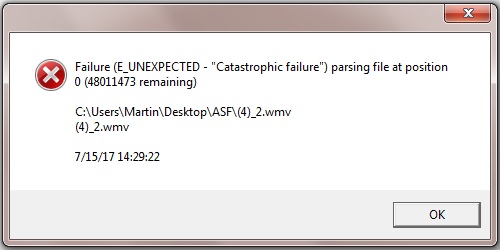

    Microsoft Windows Media ASF Viewer to see what's in it
    This file was recovered by software from accidental deletion - it showed 'excellent' quality, but I guess, due to the missing or corrupt asf header, it is damaged beyond repair.
