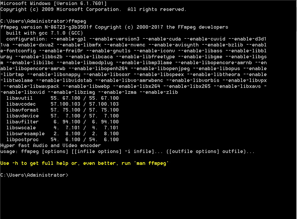

    Firstly thank you very much for help and for your patience.
    I already gave up using winff so I uninstalled it and decided to restart from scratch with a clean ffmpeg.
    Here I'm attaching a screenshot.
Name:	ffmpeg version.png
  7. You're welcome (but my patience has a limit)
    Okay, a screenshot, that's something. Now how about your command line?

    I know how to use the options in the console just I thought a screenshot was enough to show the result:
    Microsoft Windows [Version 6.1.7601]
    Copyright (c) 2009 Microsoft Corporation. All rights reserved.
    C:\Users\Administrator>ffmpeg
    ffmpeg version N-86723-g3b3501f Copyright (c) 2000-2017 the FFmpeg developers
    built with gcc 7.1.0 (GCC)
    configuration: --enable-gpl --enable-version3 --enable-cuda --enable-cuvid --enable-d3d1
    1va --enable-dxva2 --enable-libmfx --enable-nvenc --enable-avisynth --enable-bzlib --enabl
    e-fontconfig --enable-frei0r --enable-gnutls --enable-iconv --enable-libass --enable-libbl
    uray --enable-libbs2b --enable-libcaca --enable-libfreetype --enable-libgme --enable-libgs
    m --enable-libilbc --enable-libmodplug --enable-libmp3lame --enable-libopencore-amrnb --en
    able-libopencore-amrwb --enable-libopenh264 --enable-libopenjpeg --enable-libopus --enable
    -librtmp --enable-libsnappy --enable-libsoxr --enable-libspeex --enable-libtheora --enable
    -libtwolame --enable-libvidstab --enable-libvo-amrwbenc --enable-libvorbis --enable-libvpx
    --enable-libwavpack --enable-libwebp --enable-libx264 --enable-libx265 --enable-libxavs -
    -enable-libxvid --enable-libzimg --enable-lzma --enable-zlib
    libavutil 55. 67.100 / 55. 67.100
    libavcodec 57.100.103 / 57.100.103
    libavformat 57. 75.100 / 57. 75.100
    libavdevice 57. 7.100 / 57. 7.100
    libavfilter 6. 94.100 / 6. 94.100
    libswscale 4. 7.101 / 4. 7.101
    libswresample 2. 8.100 / 2. 8.100
    libpostproc 54. 6.100 / 54. 6.100
    Hyper fast Audio and Video encoder
    usage: ffmpeg [options] [[infile options] -i infile]... {[outfile options] outfile}...
    Use -h to get full help or, even better, run 'man ffmpeg'

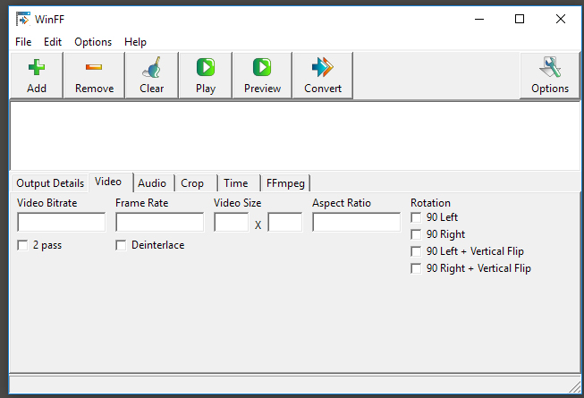

  12. Without knowing your other parameters -- why not just use the WinFF video tab which allows you to change dimensions and bitrate?
    [Attachment 42268 - Click to enlarge]
    By clicking "Display Cmd Line" under options it will show you your complete command line before converting, which you can copy and paste.
