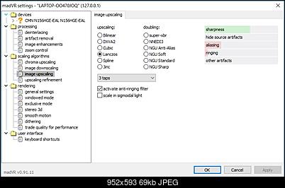

    EDIT: Okay, went into MPC's output settings and set the direct video to MadVR, now it shows up in system tray, still having a bit of trouble identifying how to upscale, i want all 720p vids to be upscaled to 1080p, but unlike ffdshow, the settings aren't straightforward, can you give me a hand?

  8. madvr scales the video to the size you are watching the video at. If you go fullscreen it is scaled to your display resolution. So if you go full screen on a 1080p monitor (with Windows/GPU driver set to 1080p) madvr will scale to 1080p. Every renderer works like this. If you want even more sharpening than the upscaling algo provides go "processing">"image enhancements" and play a bit with the sharpeners.
