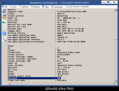

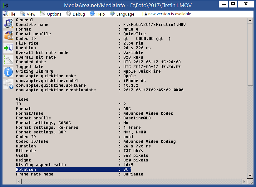

    If your video has a Rotation Flag - and your player respect it - you can change the flag with something like Movie Rotator

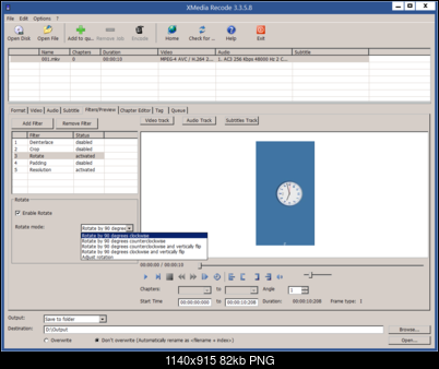

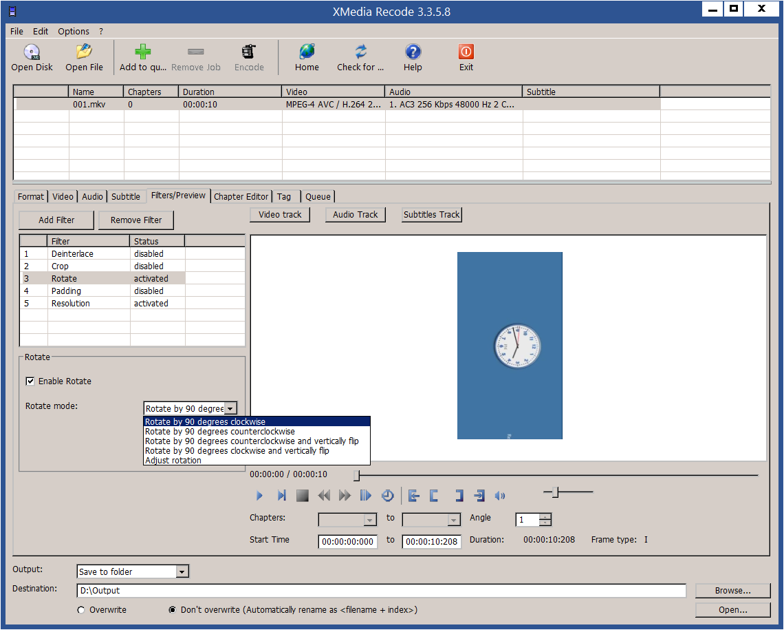

    But as above the only sure thing is to reencode. Xmedia Recode is an option.

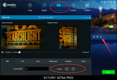

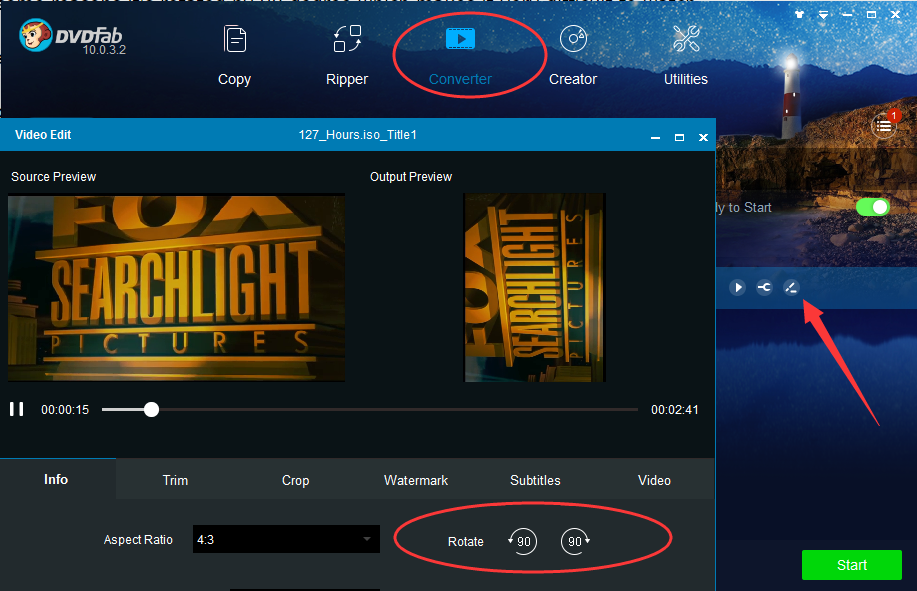

  5. In dvdfab video converter, there is a rotation option to finish your request.
