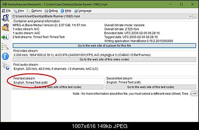

  9. Check if MP4 have removable subtitles with MediaInfo
    subtitles mark as text streams like this:
