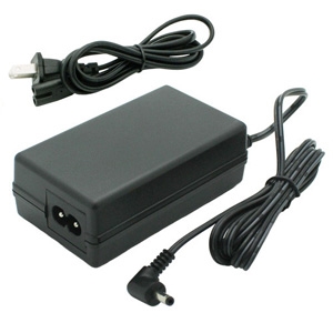

    I'd also keep any AC->DC power bricks away from your set up, by at least a few feet if not completely moved. I would be more scared of those power bricks giving off RF noise than a simple AC cable.
  8. You mean bricks like these? Yes I have them close to my stereo equipment. I will try and move them further away.

    Yes, both of those.
