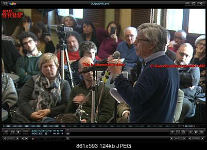

    I think that would be hard for cli batch method. There is a separate interrogation of the file to get times which then have to be checked against a known time. Are all the files going to be checked against the same time? It may be possible to send timings to a temp file and then parse as input as a variable from that file but i think it would be easier to write a specific program for this since you are talking about checking every single frame if i understand correctly
  6. Member Budman1's Avatar
    Jul 2012
    NORTHWEST ILLINOIS, USA
    It can be done like in an old post of yours https://forum.videohelp.com/threads/364382-batch-to-extract-with-ffmpeg-(initial)timec...-to-a-txt-file. You can get the information and even pull into a CMD file as variables but calculating how far, if ever, that timecode resides in the video is beyond me for a command file especially for batch processing.

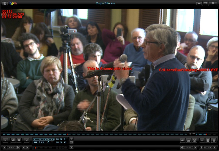

    Once you have the start SMPTE TC you can display it in the video
    01:57:15:12 leaves 13 frames left until 01:57:16:00
    01:57:16:00 leaves 100 frames until 01:57:20:00 (4 seconds x 25 fps)
    113 frames into the movie
    DirectShowSource(("C:\Users\Bud\Desktop\C0007.MXF"), Pixel_Type="yuy2").Crop(0,0,-0,-0).DelayAudio(-0.0)
    LanczosResize(960,540)
    Subtitle("C:\Users\Bud\Desktop\C0007.MXF", x=1920, y=560, font="Arial", size=24, text_color=$ff0000, align=3)
    Subtitle("This is Anamorphic video", font="Arial", size=24, text_color=$ff0000, align=5)
    ShowFrameNumber(scroll=true, x=10, y=27, font="Arial", size=24, text_color=$ff0000)
    ShowTime(x=72, y=44, font="Arial", size=24, text_color=$ff0000)
    ShowSMPTE(fps=25, offset="01:57:15:12",x=68, y=61, font="Arial", size=24, text_color=$ff0000)
    It's much easier to do with a GUI that gets the information and utilizes it for display or calculations but it would need to be something new because I know of no program that will do that now..
