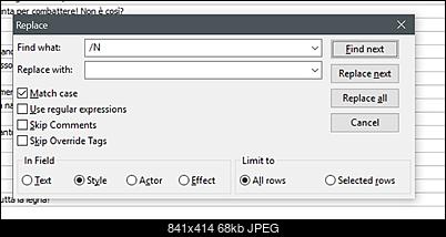

    I need to do a fairly simple thing, substitute al all the "\N" with spaces in a .srt file so that for exemple:
    Hi, how\N
    are you?
    becomes
    Hi, how are you?
    But when I search for them with Ctrl+F or Ctrl+H it finds nothing.
    How can I do this?
    Edit: I corrected /N with \N, but still nothing
  2. You have "In Field" set to "Style" instead of "Text".
    Actually I thought that was a style element, now it works, thank you!

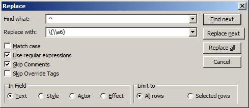

  5. Hello everyone.. I got a question
    say I want to past the codes {\a6}or{\blur5} to all lines I have ... these features are not available in "style menu" so I can't create a style for them, how do I do that ? except of pasting them in every line which is annoying!
    note that when I select multiple lines and make any edit to one of them .. all the contents change to the first line
  6. Try: "Edit"->"Find and Replace (CTRL+H)".
    Tick "Use regular expressions". Select "In Field": "Text".
    Find what: ^
    Replace by: \{\\a6}
    Click "Replace all"
    Google "regular expressions" for more information. Basically, "^" means "beginning of line". Because "\" and "{" have special meanings they should be "escaped" to "\\" and "\{".
    [Attachment 48459 - Click to enlarge]
    Last edited by sneaker; 19th Mar 2019 at 05:18. Reason: { is special character as well

  8. thank you guys.. that helped a lot ..
    @sneaker .. it works fine this is much easier now ...
