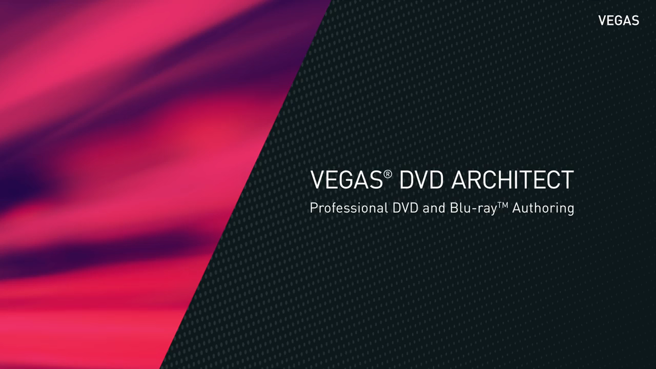

  1. Hi everyone, I am searching for a video encoder (prefer the new standard HEVC/H.265) that can convert this sample video attached (which is AVC/H.264) into a smaller file size (or even equal to the original) with the same quality. I have tried encoding to both formats using IFME, HandBrake, Premiere 2017 and none of them can seem to do the job well.
    What interests me the most is Vegas 14 can't seem to do anything better either even though I think it's safe to assume that the original video clip is rendered in Vegas. Probably I haven't found the right settings yet so if anyone can give it a try and point it out for me, that would mean a lot.
    Oh and I am using the first frame of the video to compare with the result file.
    Thank you very much in advance.
Name:	VEGAS DVD Architect – DVD and Blu-ray Disc authoring.png
