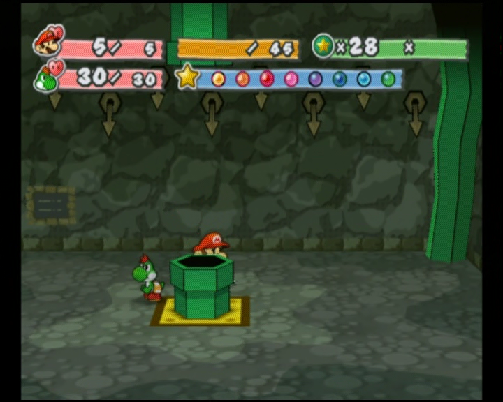

    While there is a little noise the main problem is the chroma subcarrier. PAL dot crawl artifacts show a pattern that repeats every four frames (which is one reason why the NTSC dot crawl removers don't work with PAL -- the NTSC pattern repeats every 2 frames). If you use SelectEvery(4) to view the video you'll see the pattern stands still. And there is no pattern in greyscale parts of the picture.
    A native RGB or even s-video signal would not have this problem. So somewhere the chroma subcarrier is leaking through.
    I would say the console generates a native RGB signal. A reason for this is that the NTSC version, which was designed without RGB output, can be modded to obtain RGB from some chip. It's common for consoles to "think" in RGB first.
    However I have to admit that even when I connect it directly to the TV some interference can already be seen. I used to think it was just because of the cheap cable, but now I realise that composite video is used for sync. That's probably where it all begins.

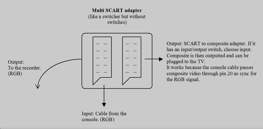

    I'm sorry, but I think you are in a misunderstanding. I finally found a splitting solution, as I said in the first post. Thanks for trying to help.
    This is a very clumsy solution, but it does the job if you don't have a lot of material to make anything better.
    With another multi SCART adapter and a pair of male-to-male SCART cables I think it would be possible to have RGB output for the TV.

    I'm sorry, but I think you are in a misunderstanding. I finally found a splitting solution, as I said in the first post. Thanks for trying to help..
    Well... active VGA splitter will provide proper signal conditioning - passive splitters will not separate you from typical problems - too low impedance - too many receivers connected to 75ohm output - this may reduce signal level, reduce bandwidth, introduce some phase distortions in analog signal and in very bad case scenario it may damage damage signal source (usually not the case but theoretically possible in badly designed HW).
    In your connection diagram - double load may be present ot CVBS line - this ma reduce level of signal - important for synchronization pulses - some devices can be more tolerant some not, additionally to insufficient level, SNR margin may be too low from SYNC stripper perspective (will lead to increased jitter and other problems).
    I have a VGA spliter, but it's passive. I think keeping analog signals in optimal conditions is too expensive for my hobbie purposes. However, I admit that I should have bought a better quality cable for the console. I do regret that.

    https://www.retrogamingcables.co.uk/nintendo/gamecube/NINTENDO-GAMECUBE-RGB-SCART-CABL...ITE-SYNC-CSYNC
    It would fix the interference by curing the cause of it. And except maybe the price, I don't see anything wrong with that cable.
    Probably even the one wired for standard Composite video for sync would help because it's screened.
    If I'm ever to upgrade my cable, I'll probably buy one from that page, despite what I said before about their NES cable.
    However, it's possible that my DVD recorder doesn't accept just composite sync instead of full composite video. I suspect this because the device wouldn't accept the video signal from the computer I use for playing on a CRT with a RGB to SCART adapter and the proper hardware configuration. I have to admit that I could only try with a progressive video mode (288p 50Hz, tolerated by the TV), so that might also be the reason. But I think the composite sync is farther from the standards than low-res progressive video.
