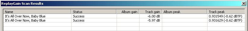

    I have the job of putting the music on my mother's MP3 player. She uses it to teach line dancing in a hall with a small sound system so I have to squeeze as much volume out of it as I can. I chose 93dB as the number of tracks that'd clip was still reasonably low. I adjust the volume losslessly if it's possible without clipping, but for conversion I created a preset with a limiter DSP in the conversion chain.
    If you convert to a lossless format and scan the output files you should end up with exactly the volume you specified, aside from any deviations that might be caused by clipping or limiting. Lossy codecs tend to deviate by a small amount, but that's what lossy codecs do.
    Converting to 95dB. FLAC first, AAC second in the screenshot below. Oh.... and Foobar2000 uses the EBU R128 scanning algorithm rather than the original ReplayGain algorithm, which is probably a bit more accurate, so the result can be a little different if you scan with MP3Gain. Mostly they tend to agree to within about 1 or 2 dB, if memory serves me correctly.
    The track I used for converting was originally scanned with MP3Gain so I scanned it again before converting it. MP3Gain had saved a TrackGain of +0.06dB to the tag. Foobar2000 said the track gain is -1.55dB, so in that case the difference between scanning algorithms is around 1.5dB.... I thought I'd mention it in case that bothers you.
