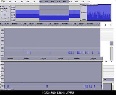

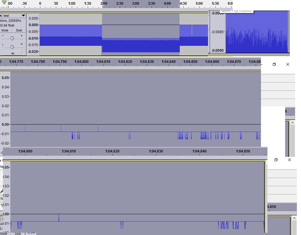

    This is picture of the waveform in audacity. The grey box in the middle is an attempt at declipping. In the very left is a closeup of the audio. With further zoom on the timeline below

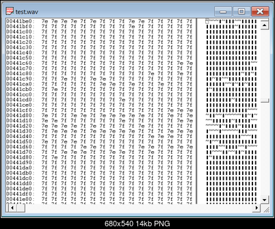

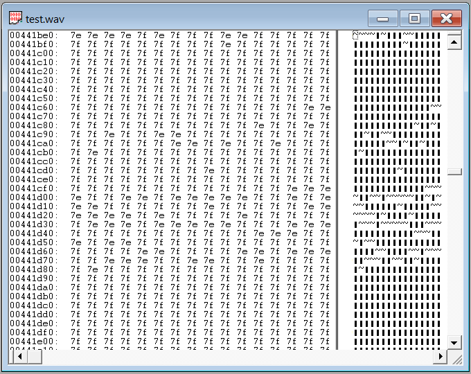

  10. There's nothing wrong with the audio in that WAV file. It's simply silent with a little noise. The samples are bouncing back and forth between 126, 127, and 128 (8 bit unsigned integers with possible values from 0 to 255). They look the way they do in the Audacity screen caps you posted because you applied a large amplification.
    Open the original video file in a hex editor and look for the audio chunks. If the WAV file accurately reflect the original audio you'll see audio chunks like:
    Note:
    7e = 126
    7f = 127
    80 = 128
    So the above represents a flat waveform (silence) with a little noise, exactly what you hear when you play the file.
