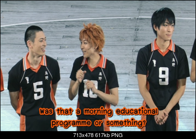

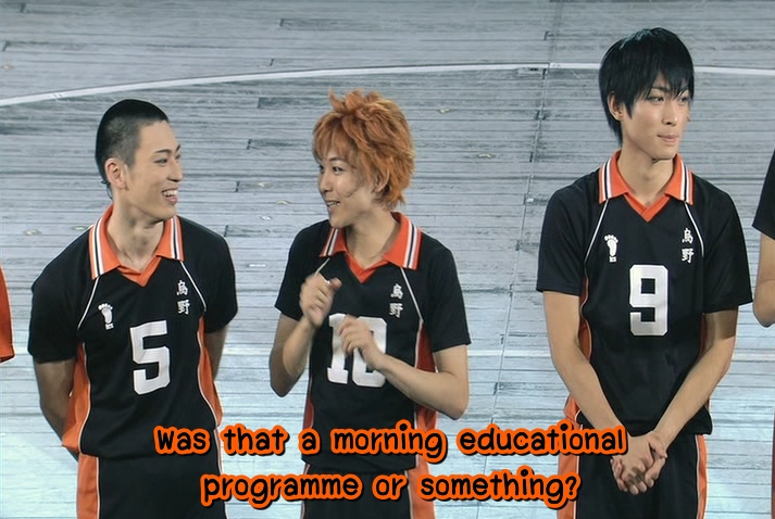

ID:	42070Click image for larger version

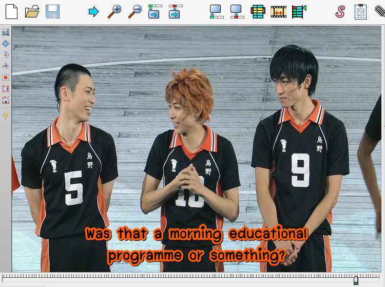

    As you can see, the subtitle on Aegisub looks quite sharper and has slightly better colour.
    The difference is very slightly, but I'm just curious if there is a way to make it better?
  4. I don't know from the top of my head but it could be in Aegisub the subtitles are without chroma-subsampling (4:4:4) while your video is not (4:2:0 / yuv420p). To achieve the same sharpness you'd need to upscale at least the chroma. (see ffmpeg pixel formats)
