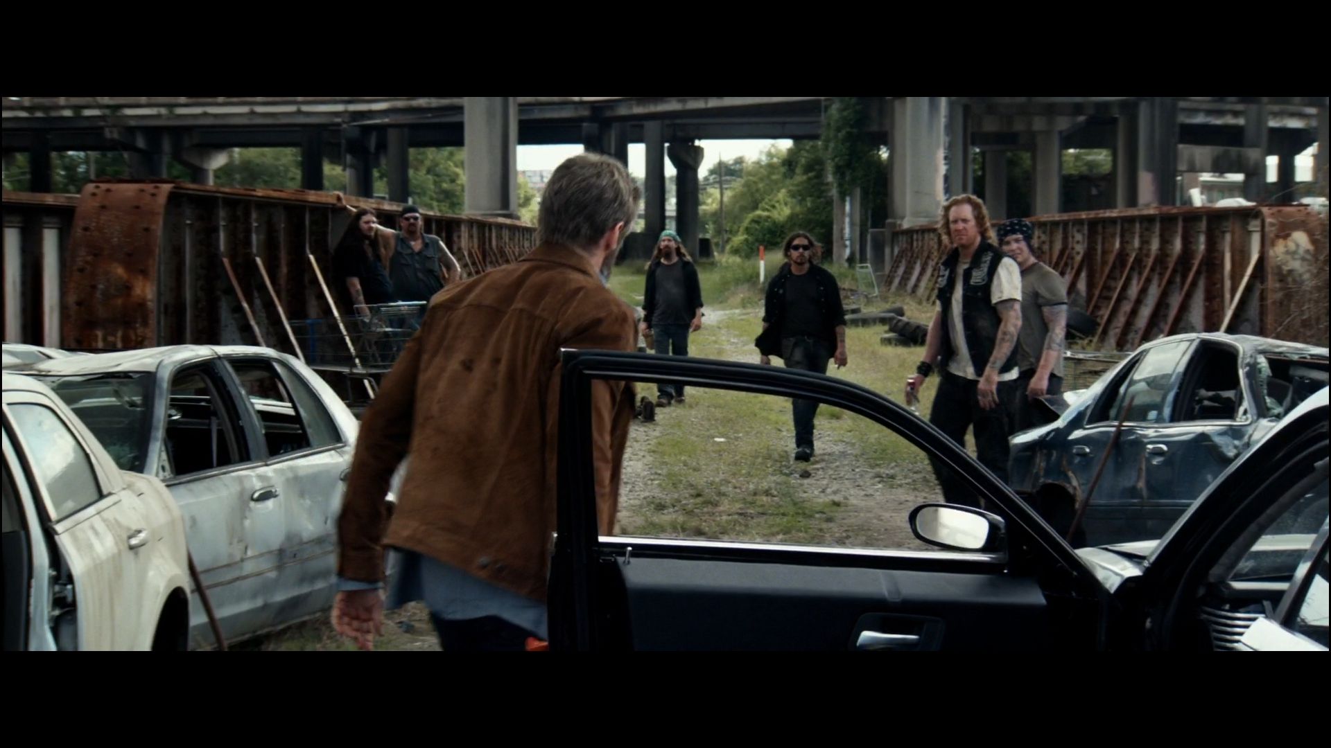

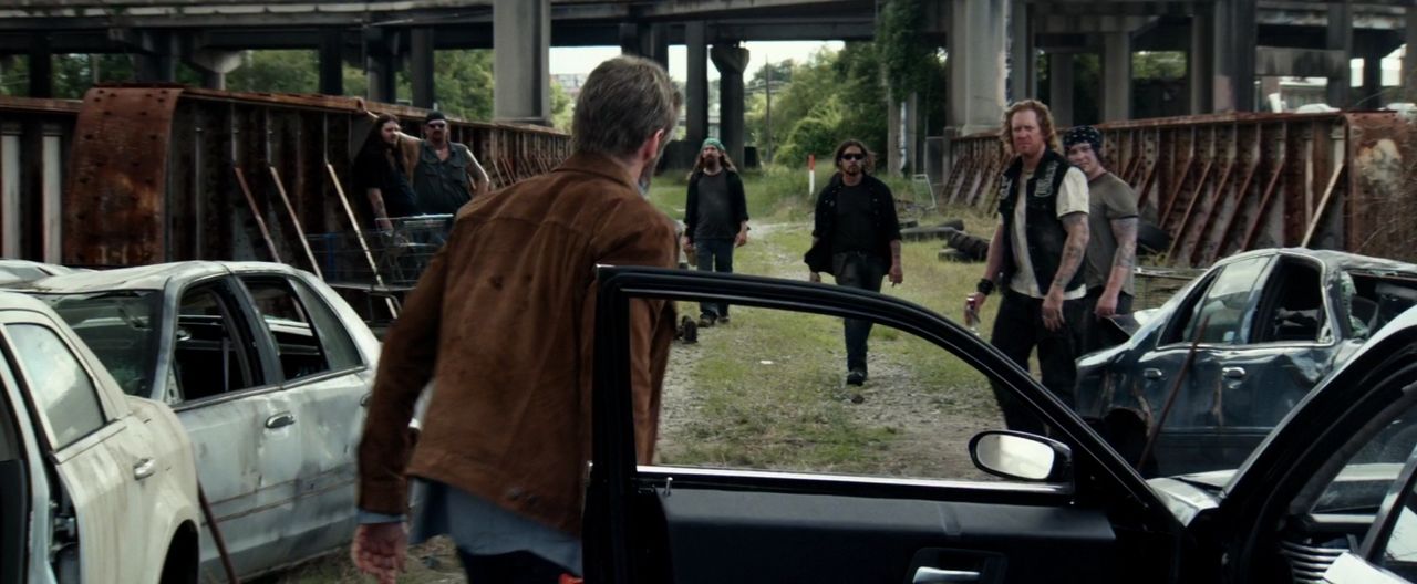

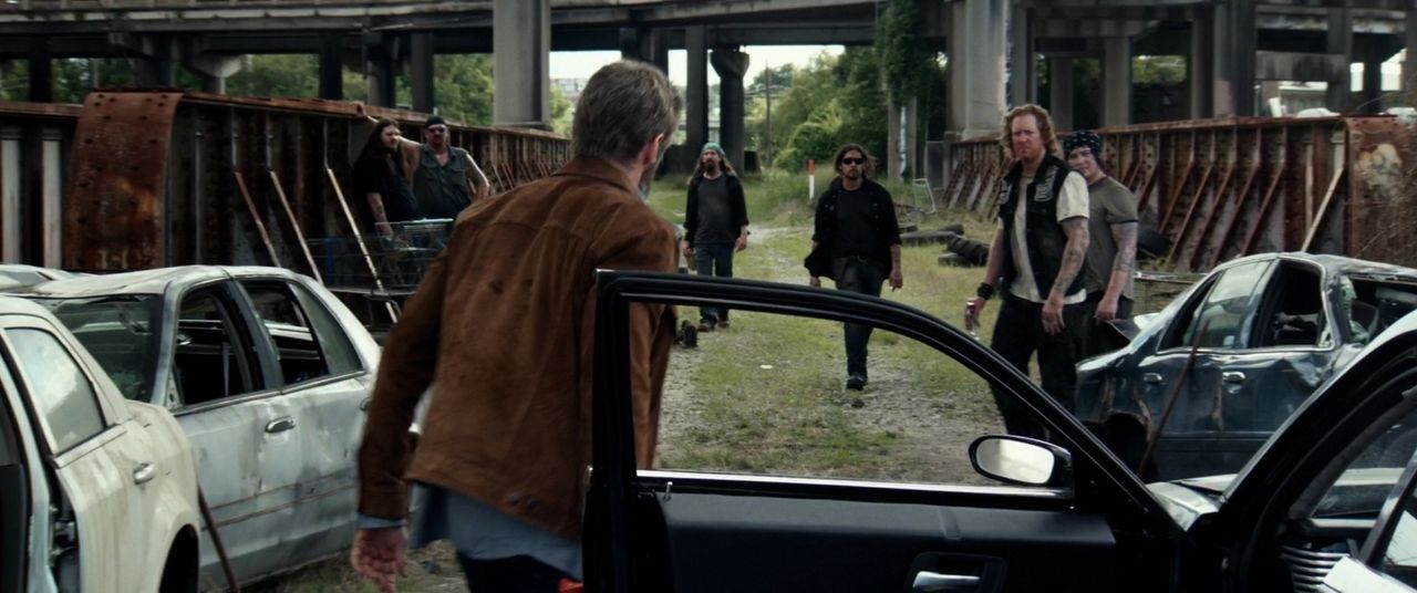

  19. What is about the calculation of resizing that you're too silly to grasp? I'd help you understand if I could, but I've explained it every which-way and even tried dumbing it down so much my cat now knows how to do it, but not you.
    Here you go. Feel free to tell me which pictures are distorted, aside from the anamorphic ones, of course.
    Original 1080p
    720p (1280x536)
    720p mod16 extra height cropped (1280x528)
    720p mod16 extra width cropped (1280x544)
    576p (1024x428)
    576p mod16 extra height cropped (1024x416)
    576p mod16 extra width cropped (1024x432)
    Anamorphic NTSC
    Anamorphic PAL

  20. You omit crucial information we talk about on couple of pages ,certainly you do not want me to verify aspect ratio from a picture, how did you crop first?
    So listen carefully, can you tell me what did you crop to first, 1920x what?
    Can you give mu just that number, can you be that kind and give mu just that one number, nothing else?
  21. You really have quite the audacity to ask for numbers now when you've been ignoring the maths every time I posted examples. It's astounding really. I can only assume you have no shame.
    No, I can't give you just that one number because it doesn't exist. See the tiny lines of black down each side of the 1080p image? I cropped them too, so the number you're really asking for, at least for the first image, is 1912 x what?.
    FFS, now I've even provide pictures and you're still denying it. Are you really incapable of comparing them to see if the image is stretched or not?
    Here you go though, here's the dimensions I'm fairly sure I cropped to each time (I didn't keep notes so I had to check it again).
    720p - 1912x800
    720p mod16 crop extra from height - 1912x788
    720p mod16 crop extra from width - 1882x800
    Those dimensions all resize to the same dimensions as the images in my previous post, accurate to within less than half a pixel, so the aspect distortion when I cropped and resized to create those images was virtually zero.

    Why aren't they right? Nobody is encoding to make DVDs, and the cropping and resizing doesn't distort the picture. You're talking nonsense. I'd be ashamed to be posting in a forum dedicated to video conversion and making such ridiculous claims.

    Have you looked at the images I posted so you can show me where they're distorted, or are you going to keep your head buried in the sand and pretending they don't exist?

    I'd still like to know what's wrong with davejavu's DVD encodes, or where you found distortion in my pics, but you ignore questions as often as you ignore facts.
