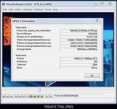

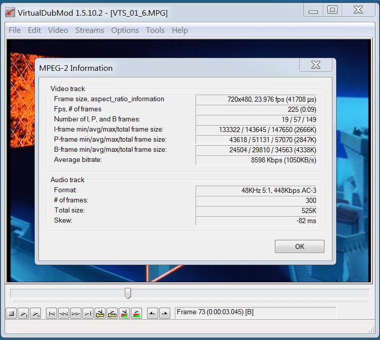

    1) How do I determine what the original or base framerate of the DVD is?
    Quickest way is to open the MPG in VirtualDub and click "File..." -> "file information" for the frame size, frame rate, and other info.
    Get more info using MediaInfoXP to get a text report on the frame structure and other data. Get MediaInfoXP here: https://www.videohelp.com/software/MediaInfoXP. A MediaInfoXP report is posted below.
    If you can't open MPG diectly in Virtualdub, you need FCCHandler's MPEG2 VirtualDub plugin. Get it here: https://sourceforge.net/projects/fcchandler/files/Virtualdub%20Mpeg2%20plugin/mpeg2.zip/download.
    The zip contains 4 files. Look over the "ReadMe.txt" file for instructions. If you're using 32-bit VirtualDub, use the 32-bit version of the plugin. If you're using the 64-bit version of Virtualdub (I wouldn't do it) use the 64-bit version.
    Originally Posted by lomaidala View Post
    2) How do I know whether to deinterlace the video or inverse telecine?
    Open the MPG in Virtualdub and scroll thru the video using frame-by-frame. You'll see interlace effects (fuzzy edges or combing) in 2 of every 5 frames during motion. This indicates pulldown (telecine, also called 2:3 pulldown).
    If you see interlace effects on every frame during motion, it's interlaced.
    MediaInfoXP reports the frame rate here as 23.976, but pulldown is used to get 29.97 fps playback. Sometime you'll just see 29.976 if pulldown can't be detected accurately. Text report from MediaInfoXP:

    With your soft telecined-flagged VOB_6 example, GSPot reports that "Pics" = 23.976, "Frames"=29.970, and "Fields" = 59.94 (follow the arrow in the image below):
    With the attached "Hard Telecine Demo B.mpg" and its hard-interlaced telecine, GSPot reports that "Pics" = 29.970, "Frames"=29.970, and "Fields" = 59.94 :
    I don't have soft-telecined DVD samples around at the moment. Whether hard or soft, telecine looks the same way in VirtualDub and other apps that don't pay attention to pulldown flags.

    While it's true that soft and hard telecine look the same in VirtualDub, it's because VirtualDub does pay attention to pulldown flags. Ie, it performs the pulldown to create interlaced frames from the progressive frames stored in the MPEG video. The old VirtualDubMod ignores the pulldown flags and displays progressive frames.
