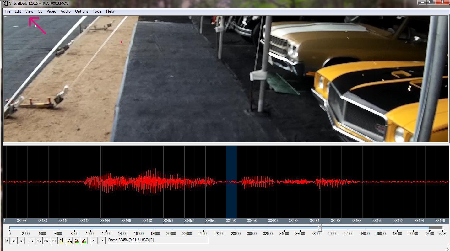

  6. I'm using the latest version of VDub 1.10.4 32bit. Is there a better version?
  7. Mod Neophyte redwudz's Avatar
    USA
    Sorry, I misread your initial post.
    I've been using VD Filter Mod. Don't know if it's any help, but it has a audio display: View>Audio Display.
  8. Thanks. I'll check that out.
  9. Formerly 'vaporeon800' Brad's Avatar
    Apr 2001
    Vancouver, Canada
    That's actually a stock VDub feature.
  10. Originally Posted by vaporeon800 View Post
    Correct. However, in old VD audio display has a tendency to disappear (real pain to use!)
