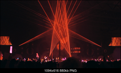

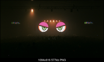

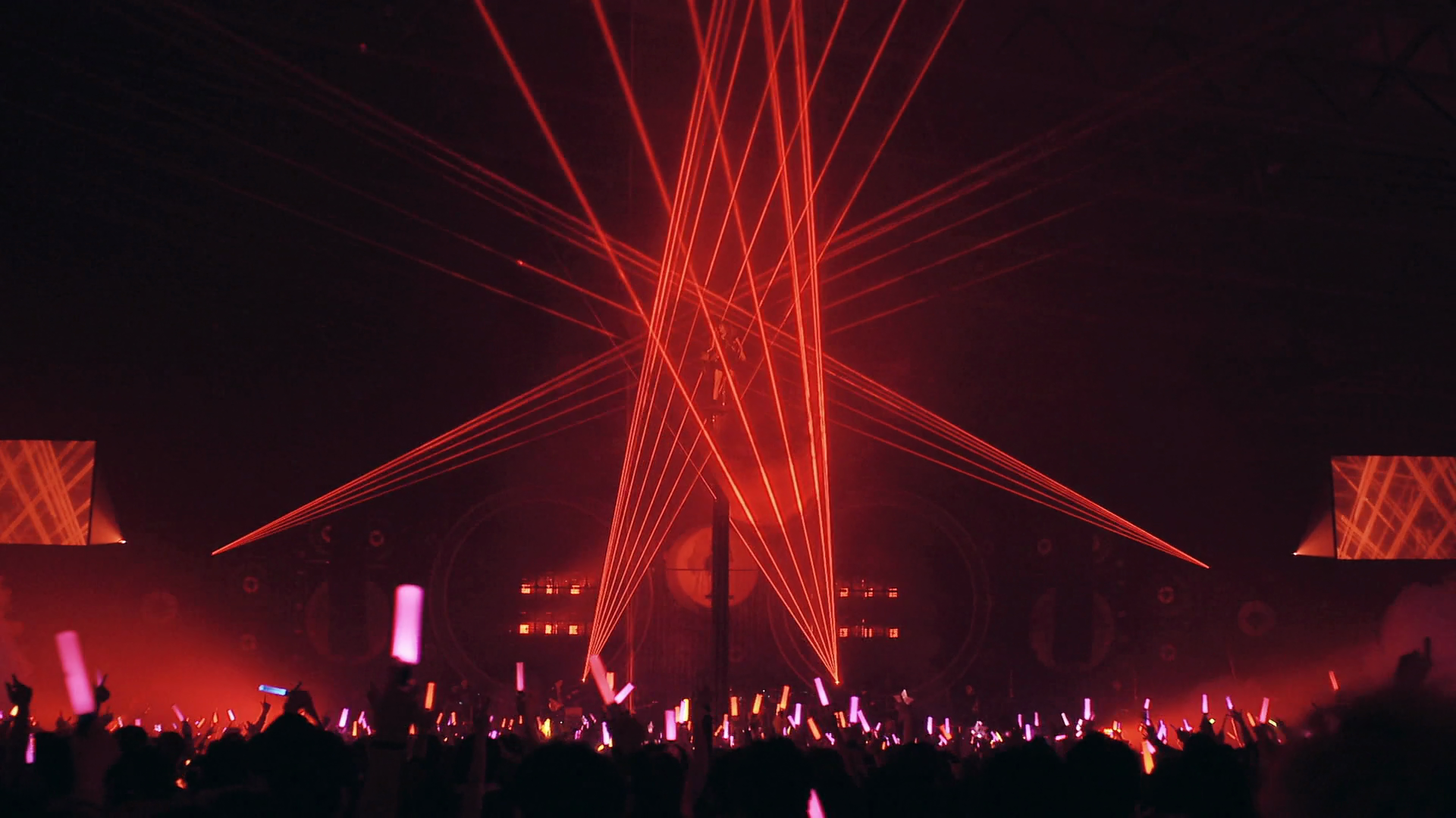

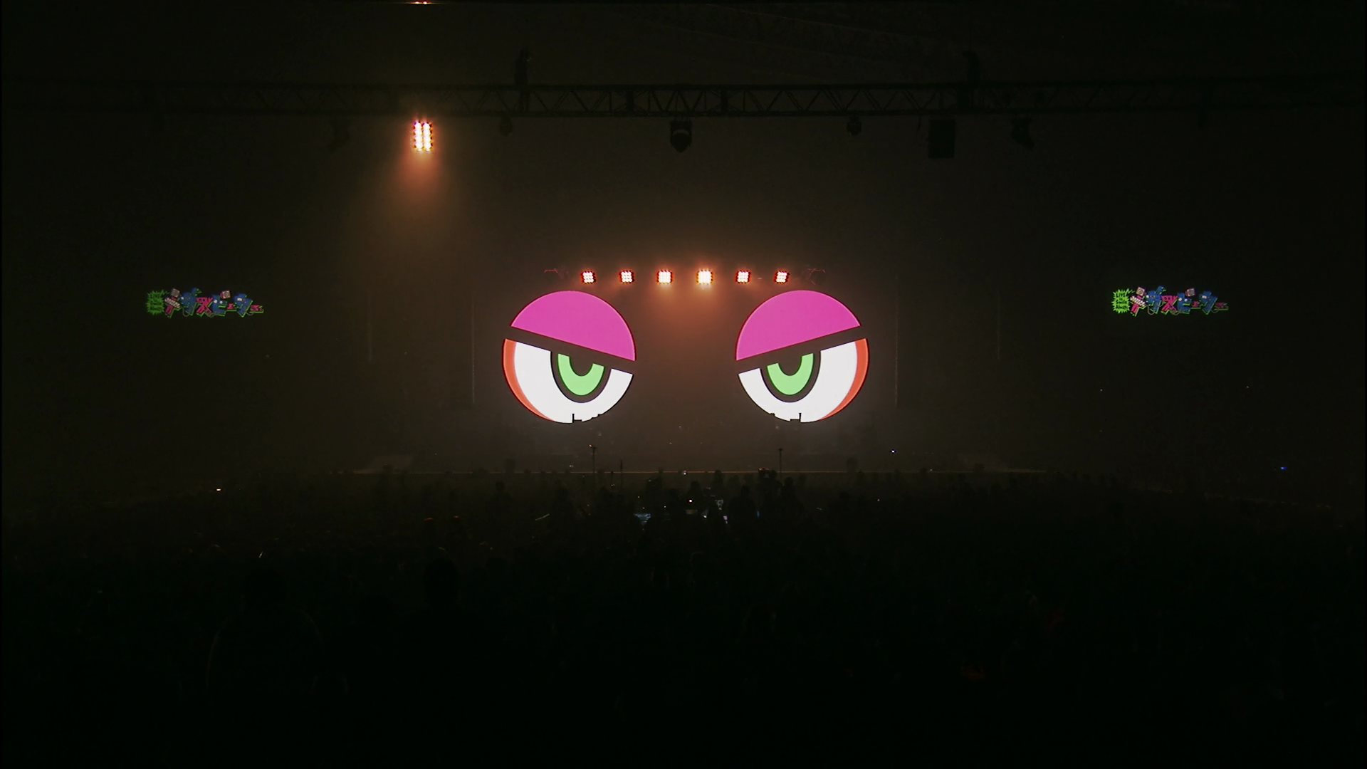

    I tried some players but only PotPlayer has that color problem! I tried everything to solve it.
    The red scale is showing like unsaturated on all videos. Red lasers in this concert turn it into oranges, for example. Thank you.
    VLC:
    POTPLAYER:
Name:	LiVE is Smile Always [メガスピーカー] 【BDRIP】.mkv_20170619_204146.495.png

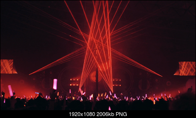

    VLC:
    POTPLAYER:
Name:	LiVE is Smile Always [メガスピーカー] 【BDRIP】.mkv_20170619_210028.852.png

    I tried before. I changed to "ITU-R BT.709", is this?
    No changes.

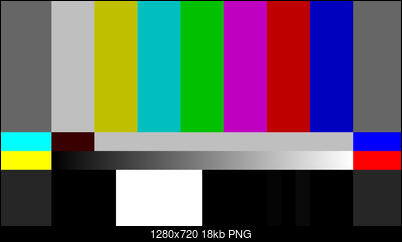

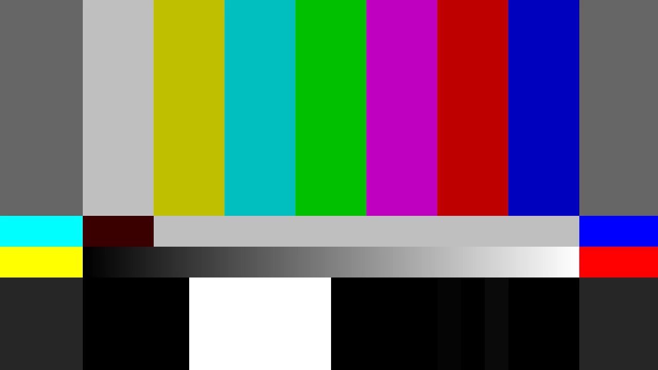

  5. Here are some samples:
    unflagged_rec709.mkv contains YUV 4:2:0 video with rec.709 colors, but the matrix isn't flagged
    flagged_rec709.mkv contains YUV 4:2:0 video with rec.709 colors, flagged as rec.709
    flagged_rec601.mkv contains YUV 4:2:0 video with rec.601 colors, flagged as rec.601
    The RGB components of the color bars should be within 1 or 2 units of 0 or 191. Ie, the red bar should be 191,0,0 (r,g,b). The magenta bar should be about 191,0,191.
    MPCHC on my computer displays all three with the correct colors. When the video doesn't specify the color matrix the general rule is to use rec.601 for SD video, rec.709 for HD video. Exactly what you see when you play these videos will vary depending on the player, the renderer the player is using, the graphics card you are using, and the graphics card's settings.

    Hi thanks, I have on VLC the same things on unflagged_rec709.mkv and flagged_rec709.mkv (red bar 191,0,1). flagged_rec601.mkv looks a bit orange (red bar 208,8,0)
    On PP I have all the 'same' colors (imperceptible), but flagged_rec601.mkv show the grays a bit more bright
    unflagged_rec709 red bar 190,0,0
    flagged_rec601.mkv red bar 191,0,1
    I tried some Video Renderers and there's no changes...
  7. Originally Posted by arbacaxi View Post
    So VLC is displaying all HD video with a rec.709 matrix, even if the video is flagged rec.601.
    So PotPlayer is following the flagged matrix and assuming rec.709 when the matrix isn't flagged.
