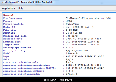

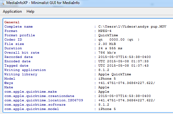

  5. aBigMeanie aedipuss's Avatar
    Oct 2005
    666th portal
    writing library is usually the program that encoded the video. here's an original video with exif data.
  6. Originally Posted by aedipuss View Post
    [Attachment 41941 - Click to enlarge]
    When I do media info of a clip from Nikon D3200 there is no writing application or camera listed
