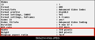

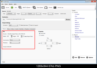

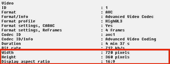

    As Davexnet pointed out, MediaInfo will probably show why you are having problems. Most of the time, it is because nasty people mess up the height and width so they can do things like add a logo or text in the new area. The whole thing is because the DAR (Display Aspect Ratio) is something other than the stored aspect ratio.
    Check the images below and you will see where I converted a 640x360 (16/9) image to 720x360 (2/1) but told ffmpeg to still display in 16/9.. Media Info shows this also.
Name:	ffmpeg script.jpg
    OOps took me too long to get this entered. but your Info does show the problem.
    Width : 720 pixels
    Height : 360 pixels
    Display aspect ratio : 2.40:1
    Aspect is 2:1 but Displayed in 2.40:1. It is always going to look wide as long as the DAR is 2.4:1

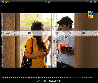

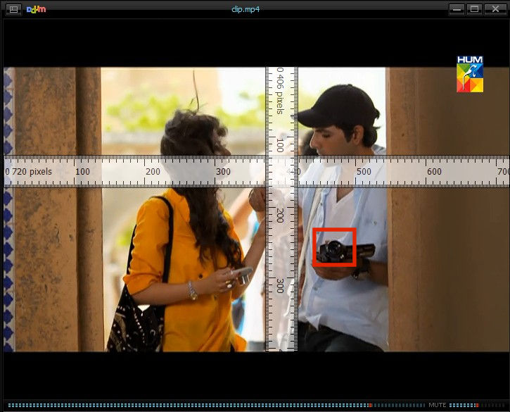

    AN EXAMPLE:
    I downloaded a video that said it was 1280 x 720 (1.778, 16/9 aspect) but this included the letterbox which they added after squashed it and then added a Logo.

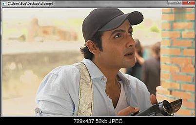

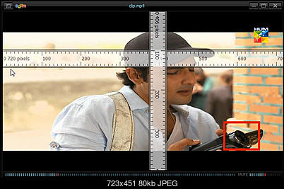

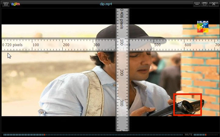

    What I had to do was find the correct viewing area aspect. I set my player to streetch the video ad use a pixel ruler to find the near correct size. (most standard size that looked OK) using the camera lens as a circle reference.

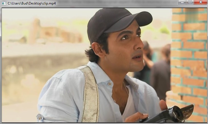

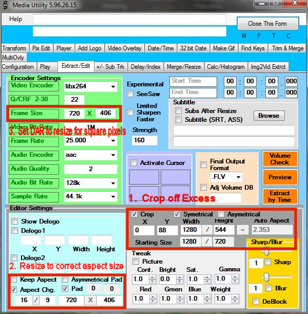

    Now use your editor to:
    1. Crop if necessary
    2. Resize to the correct aspect and size you wish. ( I reduced to 720x406)
    3. Set DAR (Display Aspect) show it matches the resize.
    What you get is correct below and I also removed Logo at 1141:68:85:86

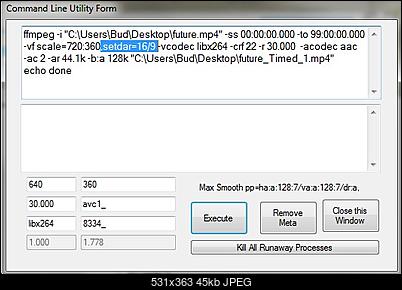

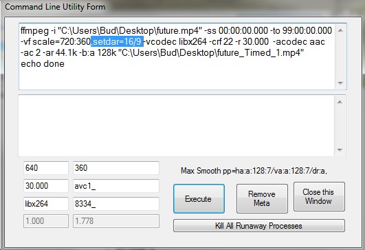

    BTW... the script in ffmpeg to do this is:
    ffmpeg -i "C:\Users\Bud\Desktop\clip.mp4" -ss 00:00:00.000 -to 99:00:00.000 -vf delogo=x=1141:y=68:w=85:h=86:band=4,crop=1280:544:0:88,scale=720:406,setdar=1.773 -vcodec libx264 -crf 22 -r 25.000  -acodec aac -ac 2 -ar 44.1k -b:a 128k  "C:\Users\Bud\Desktop\clip_Timed_1.mp4"

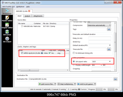

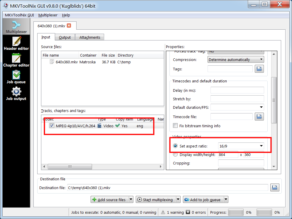

  14. Re-mixing is simply the act of taking the audio and video data out of one container and putting it into another. While doing so you can flag a different display aspect ratio. Like taking a cake out of one box and putting it another with a different label. The box has changed but the cake is the same. For example, using MkvToolNix:
    It only takes a minute and the quality of the video and audio are not changed. The only problem with this is that not all players will obey the aspect ratio flag.

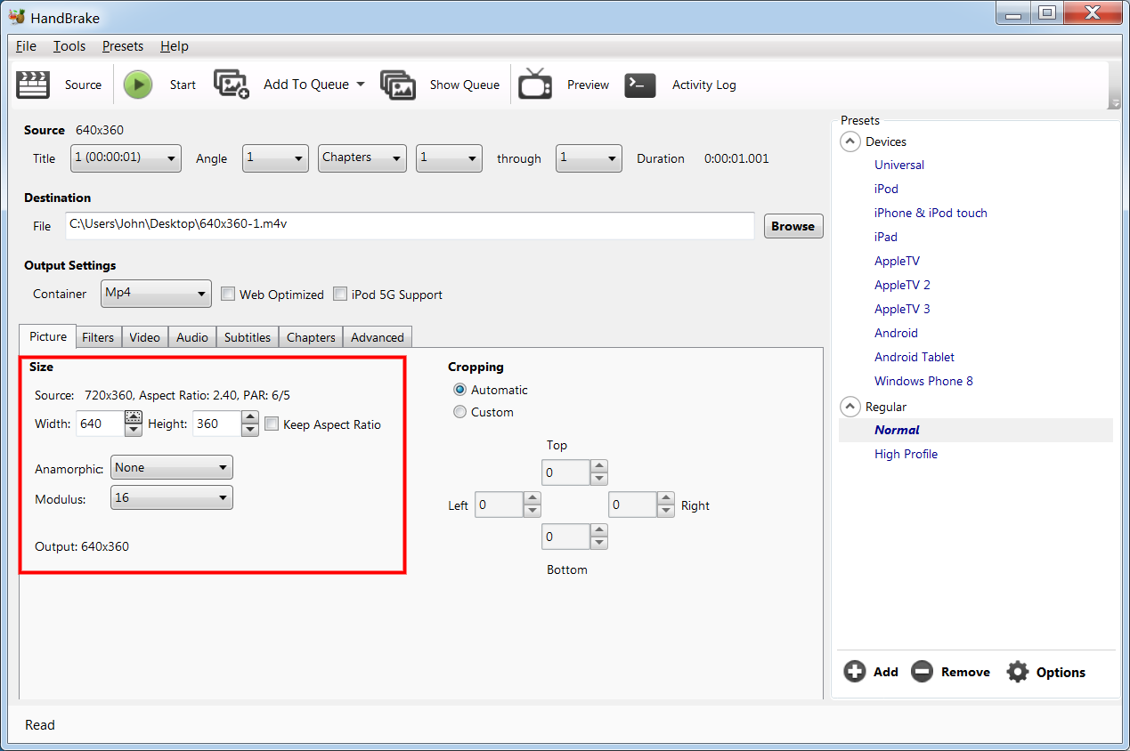

  17. Originally Posted by Kurt a Wells View Post
    Is there a setting in handbrake for this
    Just turn off the "Keep Aspect Ratio" setting, set Anamorphic to None, and resize to whatever frame size you want. If your 720x360 really contains a 16:9 video resize to 640x360.

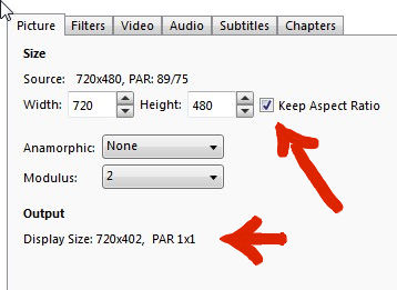

    Just to let you know, I downloaed the latest Handbrake and it looks like you can change the DAR. I used an Anamorphic video of 720x480 (3:2) that had a DAR of 16:9 and displays as 854x480. Notice anamorphic set to automatic will end up being the original 16:9 DAR
    If you change Anamorphic to none, a new checkbox pops out keeping aspect ration and the end result changes to 720x402 keeping the width but altering the height to a new 402 which is still 16:9.

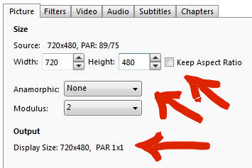

    Unchecking the Keep Aspect now allows setting the converted video to 720x480 with a resulting Aspect of 720x480 (3:2)
    Bear in mind that your video may have been altered to some dimensions that are not correct with a DAR that is even MORE incorrect. In that case you must figure out what is the correct viewing display like I demonstrated above with the pixel rulers and stretching the video.
    Videos can really be messed up with editors but the end result is, find out what it SHOULD look like, aspect wise and then change it to that size AND alter the DAR to the same .

    Jun 2017
    Fort Wayne, In
    OMG, it works! I've been using handbrake for years now and have always set it to "custom" and never even tried the "none" setting. I downloaded the same video I was having problems with the last time and it worked perfect. I can't tell you guys how much I appreciate you taking the time to teach me something new. A big Thanks You. Kurt Wells
