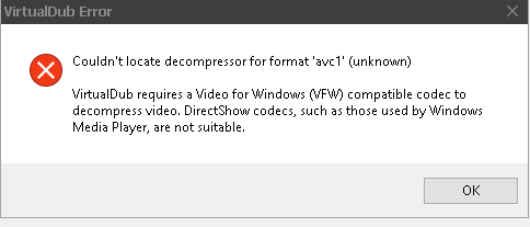

    DD= Or if you still want to re-wrap , not all A/V codecs are compatible in AVI, but you can try
    i dont know what DD= means exactly at the moment, but virtualdub doesnt work with the wrapped AVI as you said.
    error showed up as follow.
    i will search for other types of virtualdubs now.

  5. If you want to re-wrap to AVI, you need an AVC decoder for vdub. Install ffdshow and enable h.264/avc in the VFW configuration (yellow icon) set to "libavcodec" . 32bit vdub requires 32bit ffdshow, 64bit requires 64bit
